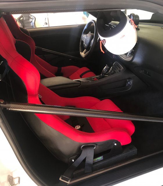

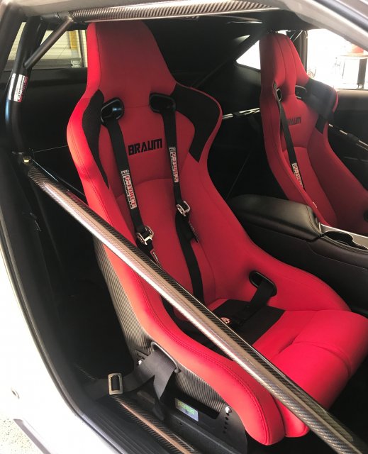

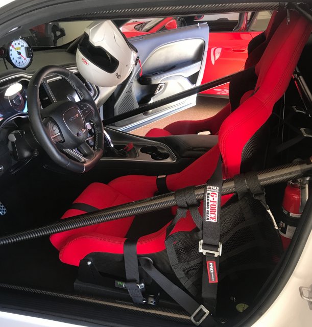

Some new interior shots for today. I love these seats! At 23 lbs each I can just leave both in for racing and not pay a weight penalty for being lazy IMG_9220.jpg IMG_9222.jpg IMG_9224.jpg IMG_9225.jpg

Looks sharp/clean. If you are going to keep your 8 speed for a while for giggles maybe leave it in drive for that 6200 rpm shift. You just never know.

Hey Marc I hadn't payed attention I really love the Red Race seats. For some reason I thought I remembered they were black.
And your post about a TH400 is really the way to go. I hear the ATI's are good and known to work well in our Hemi's and with those that also distribute them. Although My husband preferred Rossler Trans for a race car and is what he was going to have installed in a race car he was once having built. Except it was a TH200.
Your HC is built strong and you will probably race a lot once it's dialed so I think the Th400 it is also a safer bet too!

Thanks Linda. You didn’t remember wrong. The seats before were the black leather “street” version of these. They were adjustable. I changed to a one piece seat for safety at the more serious speeds. These are super comfortable and fit like a glove.
I can tell really really nice!
Yeah no adjustable allowed.
I had the seat from my husbands Drag Pak installed in my race car and I also have a Kirky race seat.
But those Red Race seats just cant be beat.....just aweome!
