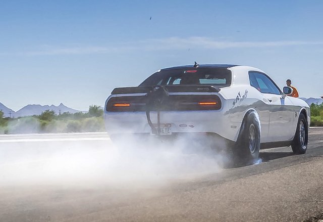

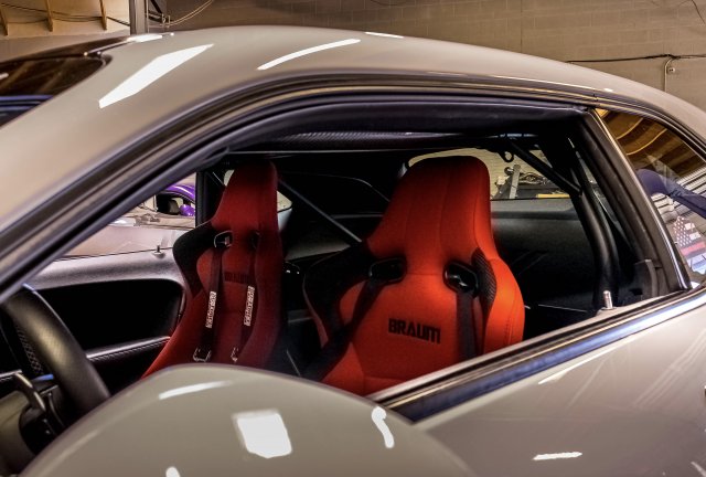

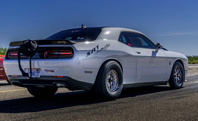

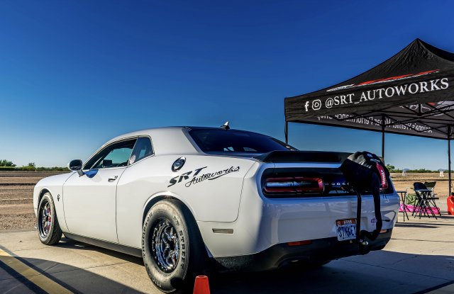

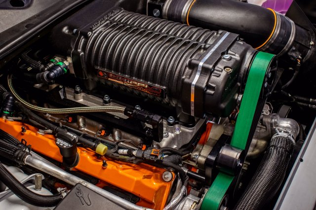

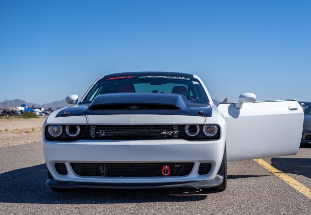

Ok Ok Ok. One more set. The pro pictures are coming in from the weekend and they’re too good not to share. From here on out we’ll keep it performance related. C9BDE660-1471-40AC-A0BA-9A2DAB151B92.jpeg 35499A6A-6D26-4195-BB97-A6F86E140B7D.jpeg 9701926D-1638-4484-826F-3BC5259D5B64.jpeg 2EAABCC5-B1DD-4F30-9E89-C40B8C4899FE.jpeg 9A5A1BB9-D159-4576-8402-3469BE163F29.jpeg

So Very Awesome!

Thread Starter #118
Thanks Linda. Now to start the long road to performance. We’ll be on the quarter mile for the first time on Saturday and get some on track data and tuning to starting putting together the puzzle of getting it down the track. Only goal at this point is learning.
