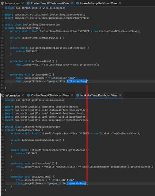

Dodge needs to patch the Performance Pages App for 2015-2016 Hellcats with the following corrections to Gauges 2 Dashboard files.
File Location 2015 (LA Challenger):
UConnect 18.45.01 version > swdl.upd > secondary.iso > usr > share > xlets > kim_packages > KIM18 > xlets > 7DEC7834-535D-47B5-BD33-695477EDCD57 > prog > jars > GSkills_MY15_LSeries_v02.01.01_FIT.jar
File Location 2016 (LA Challenger, LD Charger):
UConnect 18.45.01 version > swdl.upd > secondary.iso > usr > share > xlets > kim_packages > KIM22 > xlets > 7DEC7834-535D-47B5-BD33-695477EDCD57 > prog > jars > GSkills_MY15_LSeries_v02.01.01_FIT.jar
Current in 18.45.01
IntakeAirTempDashboardView.class -> IntakeAirTempICSensorModel.getInstance()
CoolantTempICDashBoardView.class -> CoolantTempICSensorModel.getInstance()
Software Patch Needed (2015-2016 Hellcats only)
IntakeAirTempDashboardView.class -> CoolantTempICSensorModel.getInstance()
CoolantTempICDashBoardView.class -> IntakeAirTempICSensorModel.getInstance()
This is because the current CoolantTemplCSensorModel references "LTR_Coolant" and IntakeAirTempICSensorModel references "IntkAirTempIntrClr". When the wiring was changed from MAF to IAT sensor in 2017, the signal referenced by "LTR_Coolant" is now the post-intercooler charge air temperature, and the signal referenced by "IntkAirTempIntrClr" is the coolant temperature flowing through the low-temp coolant circuit and intercooler pump.

Decided to code an alternate route and just switch the data labels on the Dashboard.
So the Performance Pages file is updated. The one caveat, this would be specifically for 2015-2016 Hellcat Vehicles.
Unfortunately, the next step is to get the update to authenticate, and that might take some time to figure out.

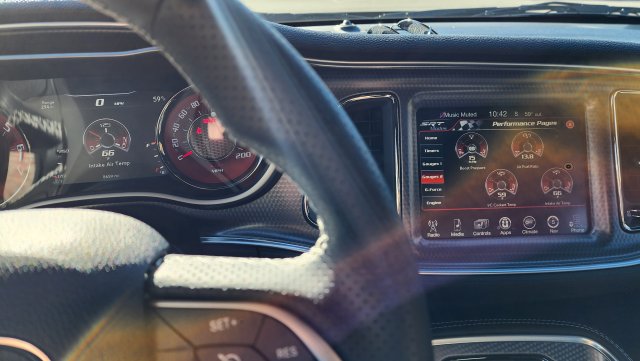

Ok, I want to confirm this, but I also want to make 100+% sure I understand what you've all been saying this whole time...
I want to confirm this because having never seen it, it is foreign to my understanding, so, you know, certainly is a fickle thing...
My center display gauges do in fact match the gauges in the Uconnect, and what you're saying is that the center driver's display has gauges swapped, correct? (I know, but I'm just being as clear as I possibly can be, being that MINE DO MATCH...)
My HC is a MY2016 M6 Challenger with Uconnect 18.45.01
