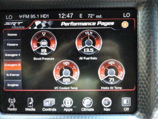

It's been several years trying to figure this out but I was able to finally track down the issue with the Performance Pages Gauge 2 Dashboard swap.
I've got the coding problem figured out. The challenge is getting the UConnect software repackaged properly so the car will authenticate/take the update.
UConnect Versions
18.45.01 - September 24, 2019
17.43.01 - January 12, 2018
17.11.07 - April 5, 2017
--- This is when the Hellcat SRT Performance Pages Gauge 2 readings between I/C Coolant and Intake Air Temp swapped ---
16.16.13 - April 13, 2016
15.17.05 - April 24, 2015
Issue (2015-2016 Hellcats)
UConnect 17.11.07 introduced a change in how the Performance Pages resolved sensor data. The updated code mapped the Performance Pages’ temperature gauges to incorrect sensor URLs (e.g., "LTR_Coolant" and "IntkAirTempIntrClr") referenced in the I/C Coolant and Intake Air Temperature Dashboard Views, resulting in a mismatch between the displayed labels and the underlying CAN signals.
The instrument cluster was unaffected because it continued to reference the correct CAN sensor IDs. This is why cluster readings for I/C Coolant Temp and Intake Air Temp remained correct, while the Performance Pages began showing cross-mapped or inverted values starting in 17.11.07 and all later releases.
Potential Fix
Dodge needs to patch the Performance Pages App for 2015-2016 Hellcats with the following corrections to Gauges 2 Dashboard files.
File Location 2015 (LA Challenger):
UConnect 18.45.01 version > swdl.upd > secondary.iso > usr > share > xlets > kim_packages > KIM18 > xlets > 7DEC7834-535D-47B5-BD33-695477EDCD57 > prog > jars > GSkills_MY15_LSeries_v02.01.01_FIT.jar
File Location 2016 (LA Challenger, LD Charger):
UConnect 18.45.01 version > swdl.upd > secondary.iso > usr > share > xlets > kim_packages > KIM22 > xlets > 7DEC7834-535D-47B5-BD33-695477EDCD57 > prog > jars > GSkills_MY15_LSeries_v02.01.01_FIT.jar
Current in 18.45.01
IntakeAirTempDashboardView.class -> IntakeAirTempICSensorModel.getInstance()
CoolantTempICDashBoardView.class -> CoolantTempICSensorModel.getInstance()
Software Patch Needed (2015-2016 Hellcats only)
IntakeAirTempDashboardView.class -> CoolantTempICSensorModel.getInstance()
CoolantTempICDashBoardView.class -> IntakeAirTempICSensorModel.getInstance()
This is because the current CoolantTemplCSensorModel references "LTR_Coolant" and IntakeAirTempICSensorModel references "IntkAirTempIntrClr". When the wiring was changed from MAF to IAT sensor in 2017, the signal referenced by "LTR_Coolant" is now the post-intercooler charge air temperature, and the signal referenced by "IntkAirTempIntrClr" is the coolant temperature flowing through the low-temp coolant circuit and intercooler pump.

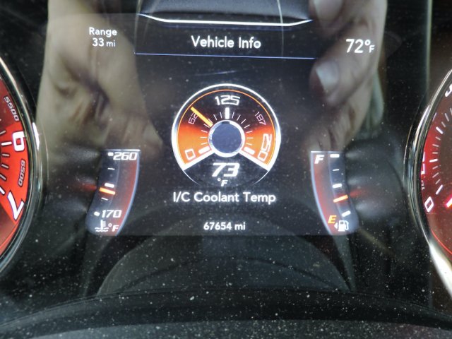

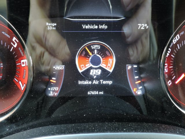

back to the topic, '15 HC M6 ver 18.45.01 and the ref'd gauges are reversed

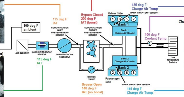

So, on an engine that’s reached operating temperature and cruising along at 50 mph or more,
are IATs normally around 30 degrees higher than I/C coolant temps? Seems counterintuitive to me.
rayzazoo
rayzazoo
#1482
135
435
Hellcat
Thread Starter #37
IATs (and really charged air temp) is normally higher than I/C coolant temps and representative of the sensors taking the measurement.
IAT (at the intake tube) passes through the supercharger and is compressed, increasing the charged air temperature.
The air is then passed through the I/C Coolant bricks in Banks 1 and 2, decreasing the charged air temperature.
The coolant flowing through the bricks is on a separate coolant loop/radiator from the coolant loop that flows through the engine radiator.
The I/C Coolant Temp is measured by the thermistor sensor at the back of the supercharger.
The Intake Air Temperature (Charged Air Temp) is the measured average of bank 1/2 MAP sensors, just after the air passes through the supercharger cooling bricks.
18,578
98,033
Thanks! Makes sense, now.
