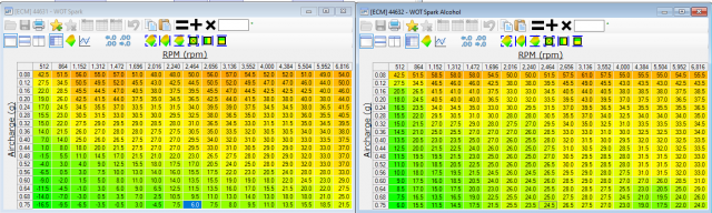

I don't think they published Separate horsepower numbers on flex fuel. But that's actually a great question because the Dodge caravan flex fuel tune I referenced had a boat load more timing in the alcohol table.

For reference, here's the timing maps from the Dodge Caravan FFV calibration I referenced when working on my Hellcat. Notice the huge bump in mid range timing in the alcohol table.
