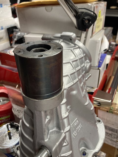

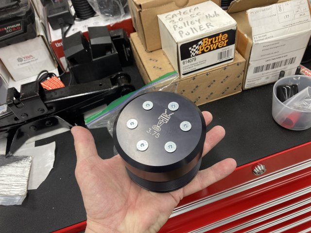

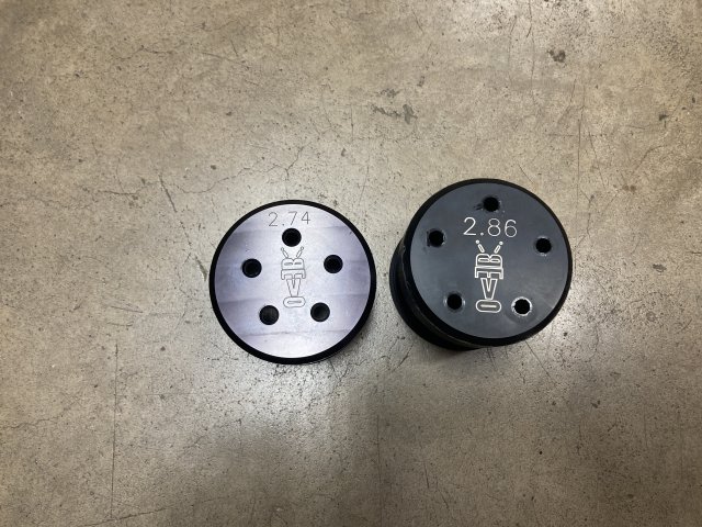

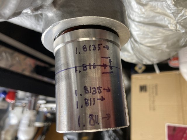

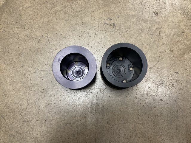

This is the latest ROH Clutch hub for the IHI, it’s thicker (larger OD, more wall thickness to support the ramp type clutch bearing underneath) then the plain 4140 pre hard steel used in the previous model(the shinny one). See in the shinny one how it swelled? Where it swelled That’s right where the clutch bearing is underneath. Took 2 hours to get the shell off, then came trying to get the clutch off the shaft to use on another blower, no way, the inner hub was squeezed down on the threads so hard it would not come off, had to send the whole snout back to Satera. I think they had to cut the shaft, They got it off, rebuilt the snout, replaced the shaft with a new one, and returned it too me with the latest hardened clutch on it and replaced all my previous design pulley shells with new ones as their ID and bolt pattern changed with every new clutch hub design. They replaced the pulley shells for free every time. Their R&D is must be costing them a fortune but like their warranty states, no questions asked or hassles replacement. That is what has kept me using this product. And I think they got it right this time. IMG_2595.jpeg IMG_2596.jpeg IMG_2597.jpeg IMG_2284.jpeg IMG_1878.jpeg
Look at this big boy that I used on my Whipple 3.8, and it still made 30 lbs of boost!!!
