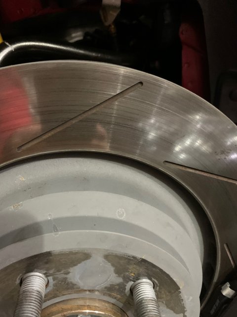

That's a great pic and if you look you can see the same tell tail line from the earlier wear mark before they were doing full contact. How many miles?
??? Powerstop Z26's since mile #15.

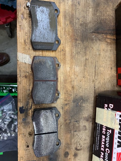

Pads are not the issue my friends, you guys have some rotors that are not right.
So IDK what you guys are looking at, but I see pictures of rotors I would immediately have replaced. Now, don't make me go pull off one of those Powerstop pads that look identical to these three. I just slipped the Powerstops in yesterday after changing my rotors back from my track set up to street. But here is what I have to back me up, those rotors are not right.
Three pads. Top to bottom...
Brembo Pad OE REWB 15 miles
Hawk DTC-70 half worn
Hawk DTC-70 three miles maybe, not even bedded

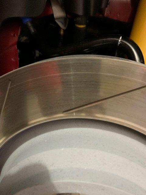

Now rotors. If anyone is imagining lines on my rotors consistent with those pictures, it is not.
Here is a closeup of the left rear again.
And its Sister on the right side..
Okay and now for the finale we have a GyroDisc aka Demon Performance rear rotor that matches the correct examples of expected OE rotors pictured above. I would be horrified to see those other rotors on a junker!
So @DodgeCares what are those rotors pictured by others that do not have the same contact area as what is normal/expected?

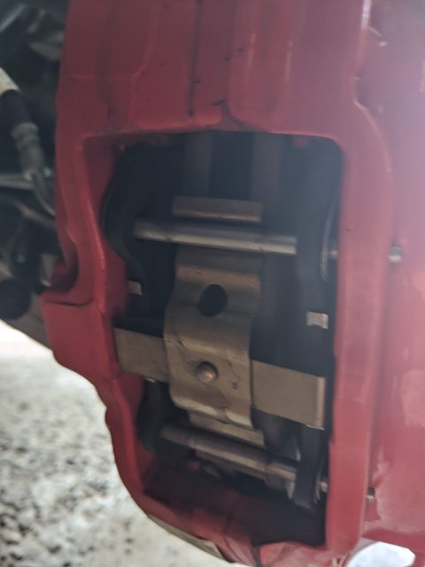

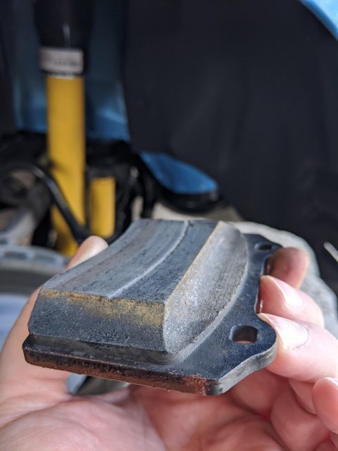

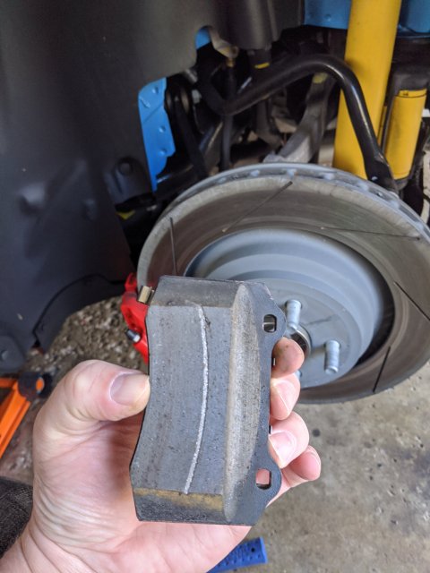

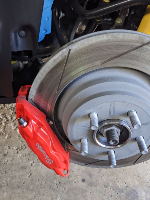

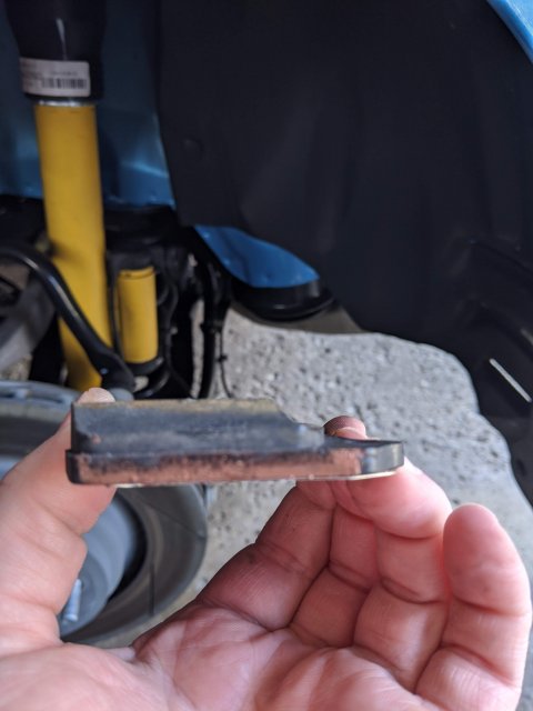

OK so they made a deliberate change for some reason, or possibly a substitution since I could see this being turned down for a smaller rotor using the same pad......I took the wheel off and tried to get a picture without taking it out....put my finger in there and was like....where's the pad? Then I said aww hell with it, I do have a small ballpeen and a punch that works....so let's pull them out.
This kind of has me P.O.'d a little.....WTF Dodge???

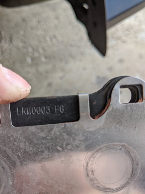

The last picture has the PN, if anyone wants to cross reference that. I am wondering what the reason is....seems like a waste of rotor surface to me! Unless there is a good reason for this shit.....PowerStop here I come!

Wow! That is quite a scallop for no discernable reason.
BTW- I googled that PN real quick and came up with normal Brembo pads (no scallop) for our cars and ZL1 Camaros (and probably most other 4 piston Brembo equipped cars).
stonewall
#1043
899
1,934
Conway
AR
2017 Dodge Hellcat Challenger
Looks like they made the pad that way. But why? that big scallop serves no useful purpose. I would be pissed! and be at Mr dealer with it.
