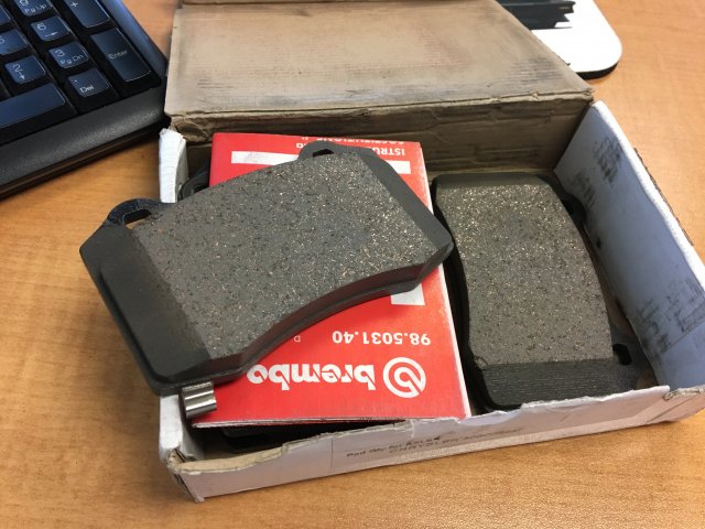

My parts manager is on the search for a set of AA or AB pads, if there's any out there.
EDIT - Looks like he found two sets at two different dealers here in Houston. I should have both sets here on Friday. Since I only have around 300 miles on the car so far, I'm sure I can just swap them out without doing anything with the rotors.

Oh I forgot....I ordered Fronts and Rears....did you order both too? not that it matters, I was going to do this anyway for dust reduction but I wasn't going to do it until later in the yea.
I just ordered the rears. My car doesn’t have the big brake kit and the dust is nowhere near the level those things create.
I think it’s absolutely asinine that FCA would create a pad that Only uses 3/4 of the rotor To solve an almost non existent noise. ITS NOT EVEN THE REARS THAT MAKE MOST OF THE NOISE! Have they no fking clue that doing so to a car like this with drivers who are far more attentive to their stuff than the average 200 driver would create even MORE problems and Ill will for them than a little noise from pads we will eventually change anyway?
granted I’m not lacking for brake power on the street with those pads on and I do drive hard but those fkrz are coming off this weekend for a set that sweeps the entire disc.
I don't blame you, I am doing the same. I went with all 4 as I have the Dynamics package and the front brake dust is horrible lol I was going to wait until the factory pads wore out, but since I am already biting the bullet on the rears I figure I might as well just do all 4. Kind of sucks to change the brake pads out on a brand new car.......I did have a $100 amazon gift card though from my birthday. Otherwise I would have ordered from Summit and I would probably have the damn things by now......stupid Amazon currently saying will be delivered on approx 4/28. I called customer service and asked how parts to keep my car safe to drive to get groceries is not more urgent? lol

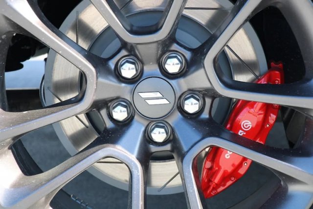

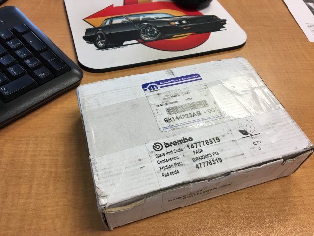

here's a pic from a new on the lot Charger.....
20,161
lol, oh man is that rich
20,161
That brake solution....
Looks like the new standard across the board for the performance brake package. Doesn't SRT have anything to say about this? Not boding well, when the performance experts at the performance end of the mother company get over-ridden by office people responding to customer comments on non- performance issues. Soooo if these same people bought RE's and complained the supercharger whine was too loud, does that mean they grind off 25% of the supercharger. Oh wait, then it would just be a regular Hellcat. :p .

Well, we could all machine down the rotors to match and loose some dead weight. :unsure::giggle:
I was looking at that too. What's the point of a rotor that big if you're going to have all of the unswept area? not to mention that this will cause the rotor to wear in a concave fashion.
