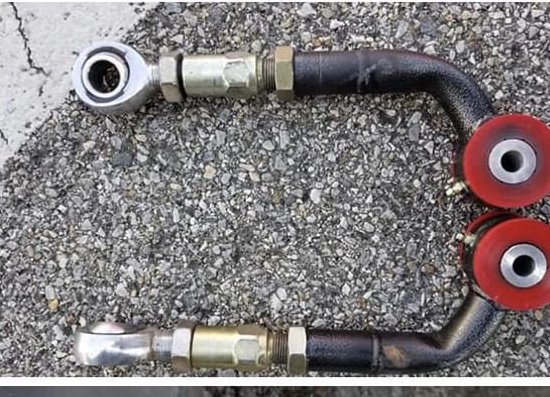

i have double adjustment and they are beefy, that's where i having trouble understanding where they are breaking! that's why we went with BMR cause they are adjustable! i don't know??? if we get to race this year we will see how they do!!

I installed the AAD arms tonight and I can tell you just do yourself a favor pay the extra money and get the AAD arms I’m telling you the other arms do not compare at all and the BMR arms honestly do look like a plumber made them and their design for pipe wrenches

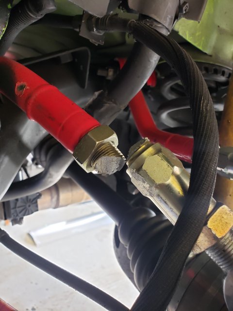

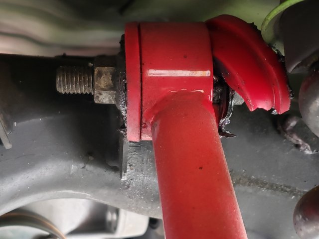

Here’s a pic of the broken arms AD4F0B96-7BFB-4F57-B2C9-EF6AEBA0D681.jpeg BE9B53F9-5EC9-4517-A21D-4D3C9EA0CF43.jpeg 4B666585-D88C-4B68-B68B-6087D76630A9.jpeg

OK, from the above pic it looks like the adjustment rod broke, they must not be a high enough grade to handle the forces thrown at em.

.. I called BMR yesterday and they did say some of there arms are 900 hp and less, and said the on car adjustable upper arms are the ones that brake. i have part numbers for those arms and also the ones they say are for above 900hp.. parts numbers are on my desk and i will post this evening the pics say it all, and the adjuster on that arm is what they said brakes and causes other shit to brake?? Thanks for the pics... that answers all the questions...

So i called BMR back again and talked with Frank he is there mopar guy! ( nice guy). So the arm that hellno posted will be the third arm that has broke in same spot( adjuster) part number ( UTA 112) on car adjustable. UPPER TRAILER ARM... So BMR has rated this arm to 900 hp? i would say that if u make stock power u Should be ok with this arm.. On the street.. But Hp modes u should use a UTA 111 arm that has single adjustment, that would need removed from the car to adjust.. That would be when it is getting alignment! and its cheaper.. SO there is the skinny... if u guys take all ur BMR stuff and scrap it that's on u.. so we know the weak link now.. they also took care of the broken arm from above pics and he also went with UTA111 arm so all is good.. i also Have ordered the single adjustment arms.. And i also asked if they would join the forum..
