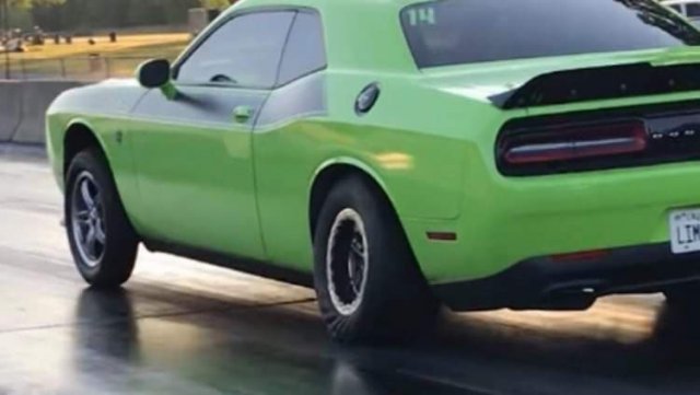

Here’s a pic he sent me of the left rear wheel mid track
do you know which BMR arm failed? i just installed a set of bmr lower trailing arms (single adjustable) on a Scatpack

He said both upper control arms
But I talked to jon Sipple and he did say on his car one of the lower trailing arms failed
