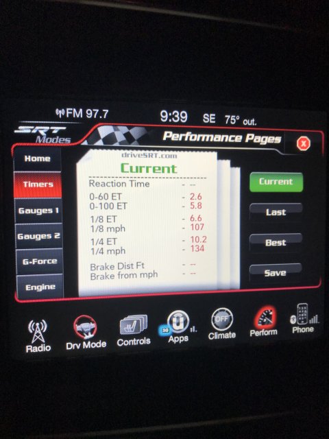

Yea I logged it Da1700 and fuel pump did ok also the car was not cooled down I’m waiting for it to cool my iat started at 140 lol and ended at 147

2nd pass after launches with no track 4th time it hooked 633D420B-D3E8-4007-B994-5E7A21A658FB.jpeg

Sucks because they have no prep races going tonight

2nd pass after launches with no track 4th time it hooked View attachment 3357
Awesome . Almost 10.2's . It's sucks when the track doesn't prep . That might be fine for civics and skodas but real cars need starting line prep .

True I think awd would help lol
I believe it has a 10.2 in it for sure I actually waited a long time and had it hooked the first time the iat was at 120 , I walked up there while I was waiting and asked them if they’re spray it for me but it fell on def ears

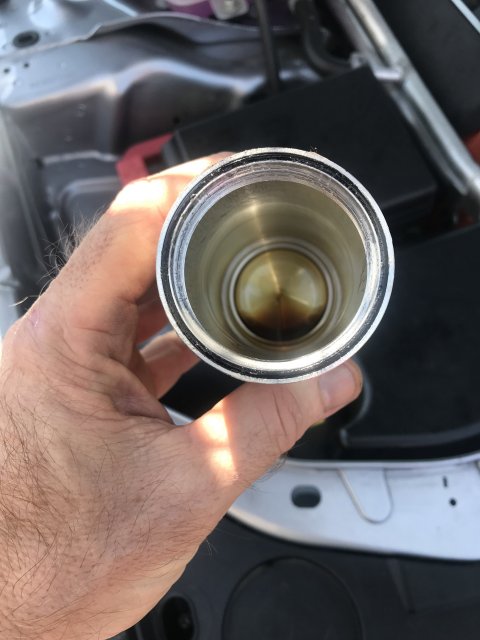

Not much blow by this is my catch can I just removed after running it this week 8EE220C4-34C5-4410-A5F6-E69144159730.jpeg
