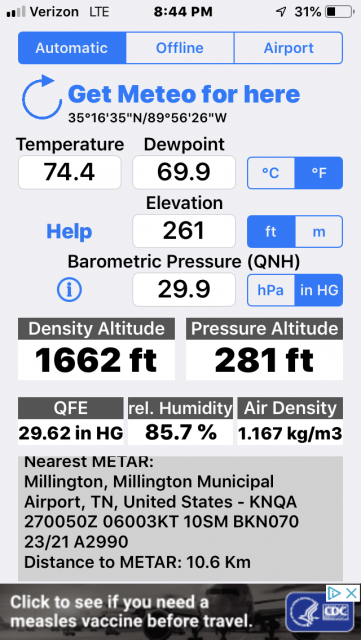

It’s cool 76 and 1700 Da
3,380
5,936
I’m waiting now temp is dropping more
Should be 73 and around 1400 Da
Humidity is 92%
