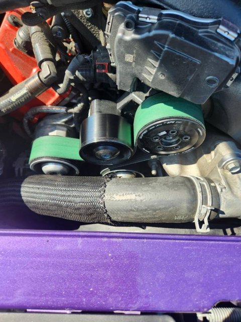

For those of you that are interested..
I'm running a 10%lower with a 3.75 upper and the AAD adjustable idler. I'm using a K100630 belt ... it's a bit on the tight side ... I'm going to try a 3.00 inch upper with this combo.
Sent from my SM-S901W using Tapatalk
Mine is way tighter than that on the tensioner, I forget my belt size but I have the aad tensioner as well and a 2.69 upper only

11,025
Thread Starter #2,248
Good to know. Thanks ..I haven't had any issues yet . Seems to be fine so far

8,659
7,629
Some people don’t realize it’s supposed to be on the other side like you have it and run it in the middle lol. It’s supposed to be in the middle of the left side, that’s a really good fit. You could actually run it a bit tighter if you wanted

11,025
Thread Starter #2,251
Here is what the 3.00 pulley looks like with the K100630 belt, AAD idler and 10% lower .
