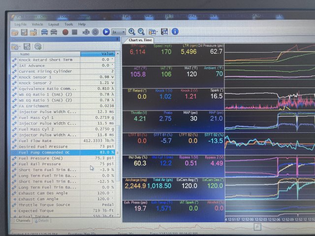

Im at + .3 DS (no driver) and +.5 camber PS, I wish I would have went +.50 DS and +.75 PS as the inner edges wear just a hair more then the outer edges. I suggest shoot for a bit positive not flat. My .02 at least observing the new rears I just put on after 7-8 60-130 passes and the last one was 60-170 pass. According to HPT time stomped on it at 45 12.48 seconds later was at 170, smooth the whole way and fuel kept up fine. DA was +2100 and 65F

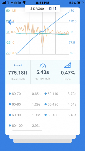

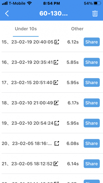

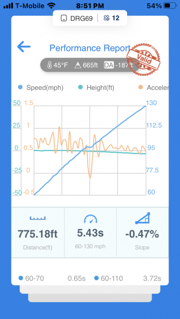

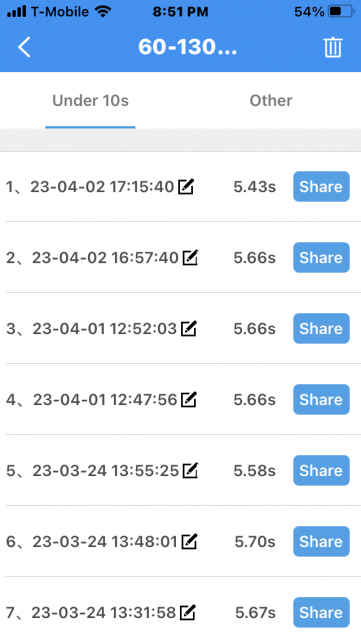

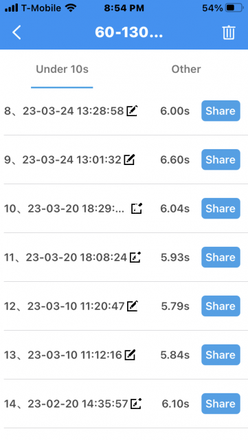

Gotcha. Yea, I’m stock springs and shocks except for the DS suspension controller.
Second report on those Continentals Extreme Contacts I was telling you about, they’re flat to the road now after 10-12 pulls and grip as good as the 555R2 or the NTO5R but has 3 times the tread depth, same 305/35-20 size. I’m hoping they get even better on warm summer streets coming!! EA81EEDB-7F50-4A69-829F-00AC65B6E1A5.png
And very consistently doing it too for a stick car on 45F concrete!
Here’s the just getting to the wear bars 555R2’s at same pressure, 27 psi cold, 28-29 on the hit.
C4EDA86B-110E-451F-B248-165B2D6F3E14.png 76368548-137B-441D-BDE4-E405F0B08520.png

Excellent!!!! I'm looking into those tires now... I really need something to help with traction .
