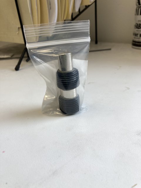

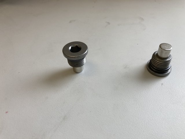

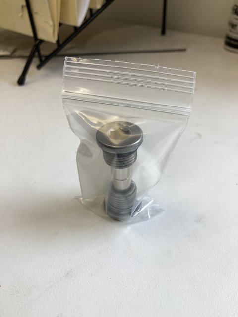

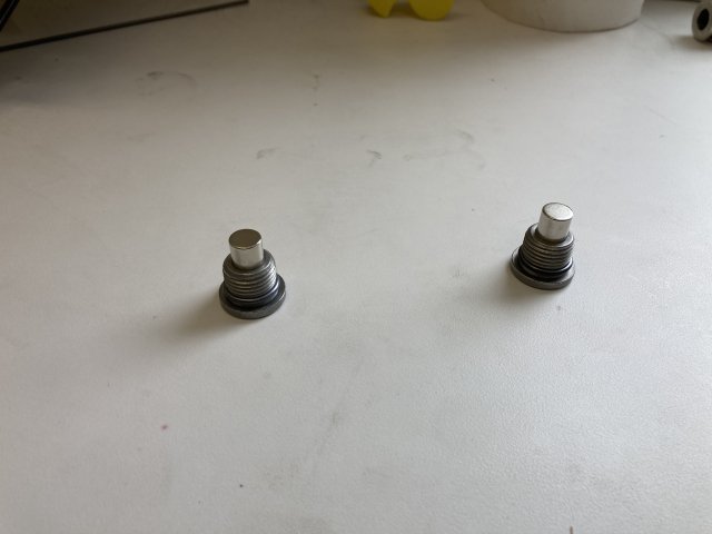

If you have money to spend by these magnetic plugs for the trans and the Diff $100 +9 dollar shipping gets you all four :). I have some ready to ship finally.

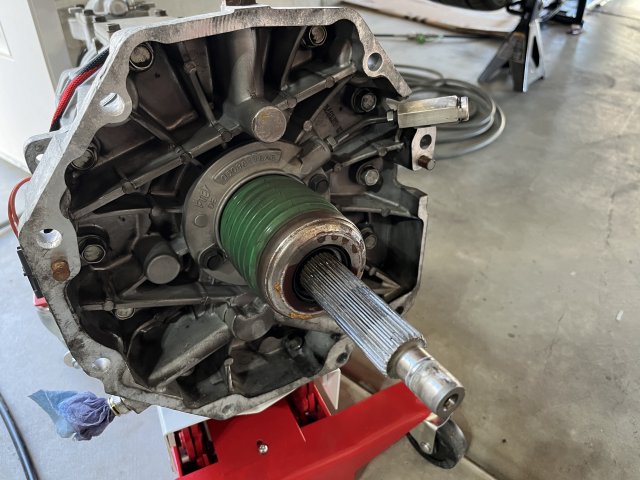

So this picture is the trans removed from the bellhousing? I was thinking about whether or not the throw out bearing (or whatever we call it) would stay on the input shaft as I separated it from the bellhousing but it appears that won't be an issue.
Drop the exhaust, mark the flanges for alignment and drop the driveshaft, remove the shifter, then separate the trans? Doesn't look like I need to drain the fluid, right?
And where did you get that trans jack, that thing looks sweet? I would like to do this on my quickjack if able, hopefully I'll have the clearance.
3,799
8,998
TOB stays on the trans, no need to drain the fluid, not much comes out of the cooler lines when disconnected. Just disconnect DS at the trans and push is off to the side (assuming 1 pc DS) No alignment tool is needed as your not disengaging the disks. Jdd as CK is from Harbor Freight, $99 I think it was, And yes the quick Jack’s will get you high enough to do the job

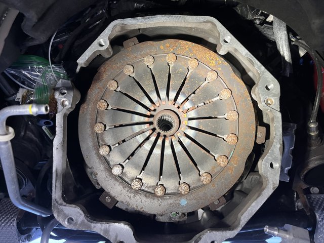

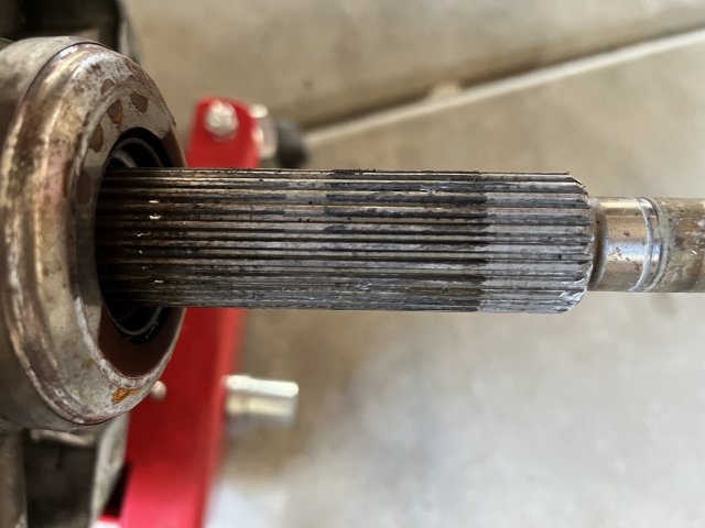

Got the trans out today. All in all it took me about 5 hours. Could’ve definitely gone faster with a helper. Pretty straightforward job but you gotta have a decent tool selection and definitely a bit of experience.
The input shaft indeed feels like dried up sticky grease. I bought the grease from the dealer yesterday, using the part number from the 2009 star case for this issue. The dealer told me it was the correct grease for what I was wanting to do but it’s definitely not the same as what is on there now or what @16GoManGoHC2 recommended, so I now I’m on the hunt to get another tube of grease. Problem is, I can’t find it in town, so it might be mid next week before I get to it.
Everything looks fine other than the grease. Surprised by how much rust there is but I’m guessing this is from being stored over the Winter and moisture building up.
Probably a North East car..not stored in a heated environment
