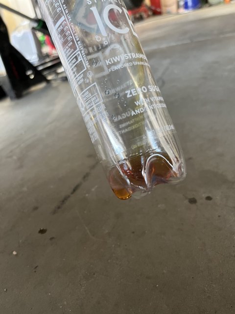

I am not talking about the transmission fluid, I am talking about the brake fluid.
Your clutch hydraulics share the fluid with your brakes, so you just have a brake fluid reservoir that the two systems use. There is not a separate clutch reservoir.
Some people have said that, as the brake fluid has degraded over time, their clutch was affected by it (I.e. not shifting properly and getting slight grinding as if the clutch didn’t disengage fully.)
My 2016 has 22k miles and when I flushed the brake fluid, it looked like sweet tea haha. Ironically I was flushing it into a used sweet tea bottle. This is the same crap your clutch master cylinder is pushing through to your clutch release bearing.
This pic is the actual fluid I flushed out of the clutch hydraulic line, which at one point was pretty new DOT 3 brake fluid.
Yepper, I got cha. These fluids do have a time barrier on em, correct? Time and usage are against em. Especially in traffic. Which is my down fall and the heat. I will look at the reservoir and check the color and smell. Burnt fluids are not good.
Yeah, that was in need of a flush. Maybe not for a minivan, but certainly for our cars...
