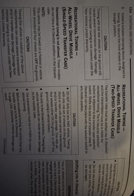

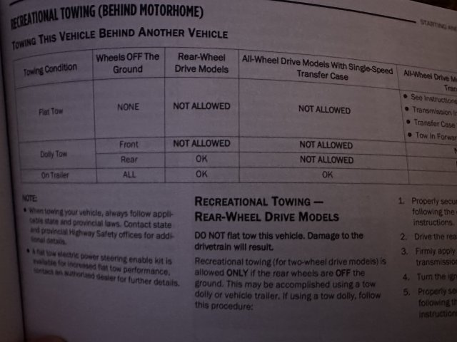

IMG_5866.jpeg How many modes does the transfer case have on a TRX? Single speed transfer case CAN NOT be flat towed.
8,514
7,445
Only if you can set the transfer case into neutral can you flat tow. Period.

My Durango is RWD, so cannot be flat towed. Period.
Without going out to look, I'd say there's normal high range AWD, high range 4WD, Low range 4WD, and Neutral.
More than enough to allow flat towing.

Was looking into a weight distribution hitch for my jalopy and was flipping through the owners manual and saw that
