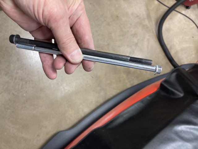

I installed mine over the weekend while replacing bearings and changing to a 2.72 pulley. Here’s a picture of 0D29C57E-B407-4C9A-B34E-87117592A5D3.jpeg 6B759B44-07E6-462D-A53B-560813525DE7.jpeg D7ACB8BC-6E3E-42D5-8F61-42A8FCEAC63F.jpeg how much longer then the socket head cap screws sent. They look Great installed as well, Good stuff 👍👍

Awesome. They really do look a lot better than the socket headed bolts. I’m happy you like them!

Bringing an old thread back to life..... I snapped one of these bolts and have no extras. I pm'd the original seller (Gteatr6) waiting for a response. In the mean time I thought if anyone had a spare or maybe a set your not going to use, I could purchase them from you. Mike
Can you expand on how you "snapped" one? It seems unlikely from tq given the low tq values?

the only thing I can think of is I must have gotten oil on the threads. And like and idiot I kept turning and snap! All of the other bolts torqued just fine. Mike
Interesting, I can see how that could happen. I have a set that I have not installed yet, as well as several sets of O.E. bolts, it might be interesting to compare torsional stiffness.

The following information is taken from the data sheet I received when the bolts were made.
Mechanical tests:
Class 8.8
Brinell hardness 268
Tensile strength (MPa) 858
Yield strength (MPa) 658
elongation % 13

Class 8.8 is the ISO number assigned. I have these on my car and haven't had any issues. I have my stock bolts too. Going to check to see if there’s a head stamp on.

Stock bolts are 8.8 as well.

Metric 8.8 is not that strong, considering there’s 10.9 and 12.9 beyond 8.8.

But Dodge chose to use 8.8 😉
higher quality steel would make for a bad day on the heads and the supercharger when you clap down. Also got to remember these things aren’t in gorilla torque spec

ISO 8.8 is approx. equivalent to SAE Grade 5
