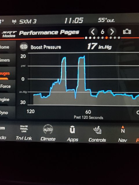

I just did a test before and after on my redeye with the 3.17. Dyno days were 1 week apart. Temp was right around 50 both times and DA was around 300ft. 93 octane with boostane to bring octane in the full tank of fuel around 96 or so. Car made 695 stock and 689 with 3.17 upper installed.. It pulled timing and went way rich to about 9.7. I would not run a pulley on a car without a tune if you live near sea level. Today u dumped more boostane in tank just to make sure it was safe to drive octane around 100 and it pulled way way harder than when stock. I saw 17 boost on the dash today.
