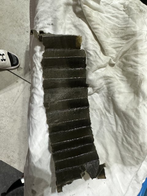

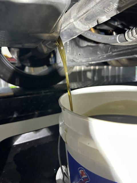

100 mile break in done! Not one spec of metal in the filter or oil! It’s go time! 😈😈
