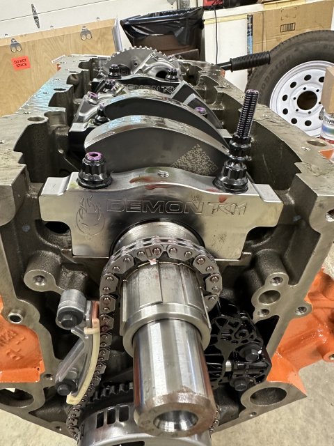

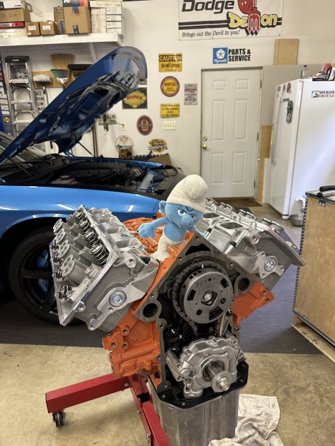

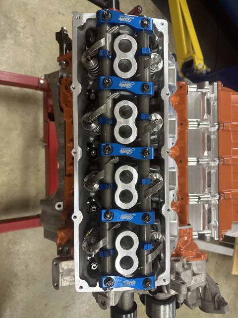

The Smurfs new heart!

Sounds like it has a miss how much oil is in it?
Hahaha 🤣 it actually took just over 8 quarts from bone dry to the full line. That’s drained oil cooler and fresh engine.
no misfires at all.

See too much oil in it drain about 2.25 qts

Thing sounds like it’s running great, always good stuff out of demon performance. Did they build you short block, or did you piece it together?

they did the short block and cam to what we decided on for my combo. I bought Thitek heads and did all the rest myself.

I always am bemused by the "plastic" timing chain guides. I know they're designed to last the life of the engine and give an indication of problems if there is accelerated wear (and that they're not "plastic") but they still look to me like they'll be chewed to bits just a few minutes.
Nice looking motor. Bet it will be fun!
