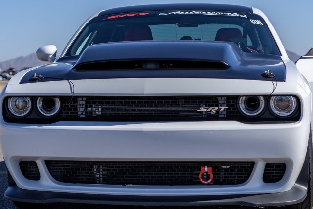

I have a hook-up welded to the front bumper but you can wrap the cradle underneath if you wanna be ghetto 😝 3B278B61-ED4E-4BD3-9FA6-0E068C0D63D7.jpeg
5,224
17,569
You have to have a hook especially on a Charger. You can’t hook up to the cradle without removing the pan and the the cable will damage the splitter and bumper either way.

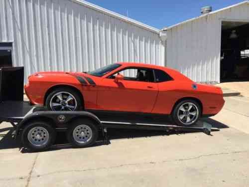

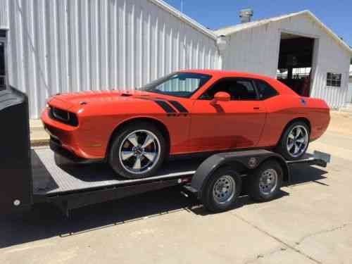

Im jelly, but you gotta piss with the cock you’re given. Going to see the trailer on Saturday. Its a 20’ Sloan KwikLoad rollback, full epoxy coated, 9k wireless winch. Comes with tire covers and a tire rack. Previous owner would take his Corvettes to watkins glen with it. Weighs 2150, has a GVWR of 7000. Thats more than enough for the cat. All the other shit can go in my flatbed. Winch battery is wired to charge from the 7 pin.
fronts yes for winching up, gonna order those for sure, for tie downs im thinking that i dont want that hook on that small ear pulling on my aluminum aad suspension…
an example of a kwikload 18’ with a mopar, no doubt in my mind now that it will have plenty of room with the 20 and the rock guard is nice too
