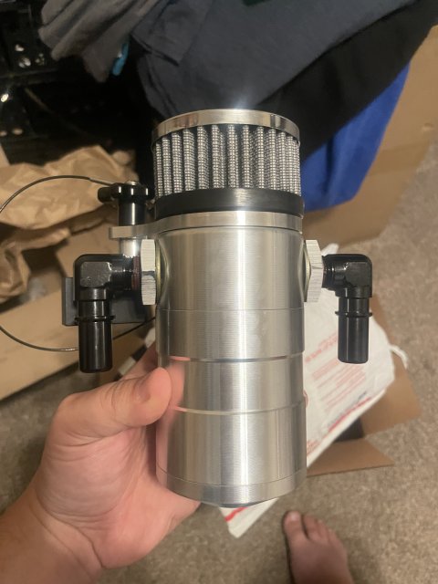

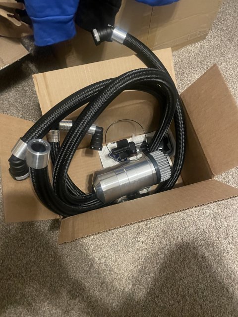

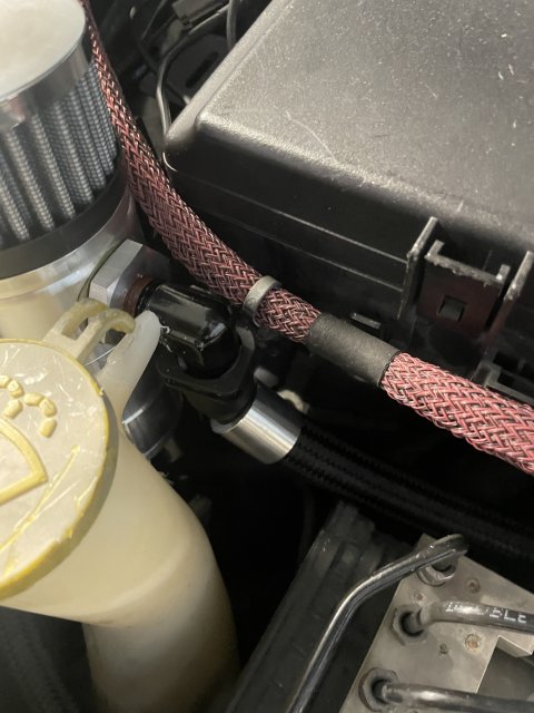

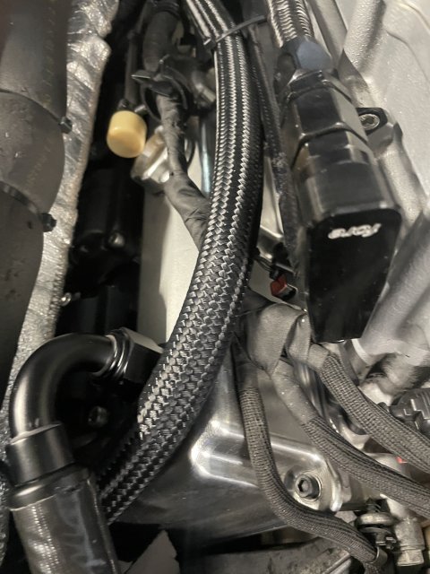

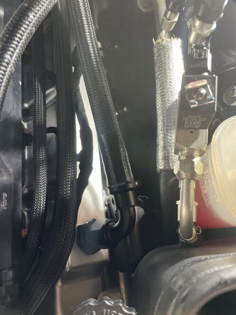

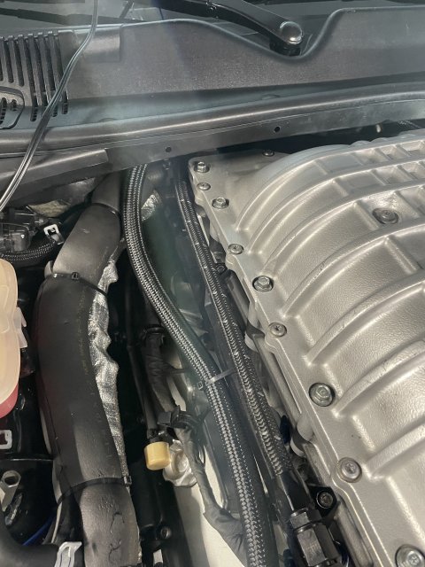

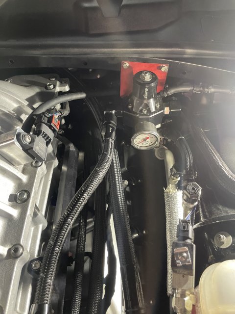

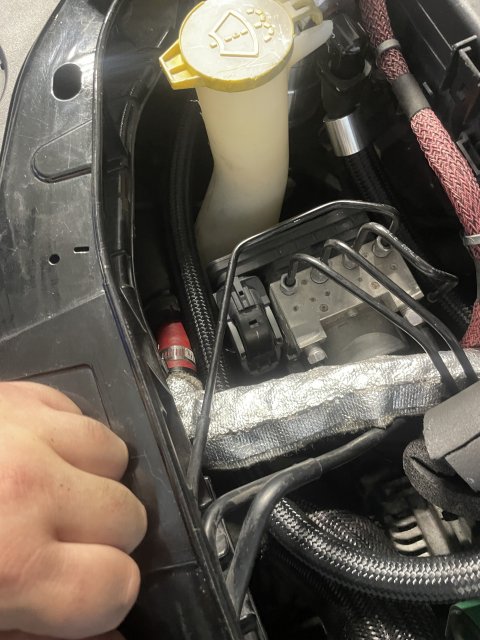

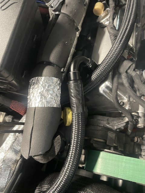

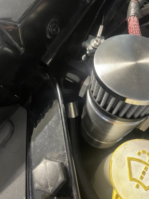

The kit is actually pretty nice. I sourced my own AN fittings for the 5/8” lines for the Hellcovers
IMG_8606.jpeg IMG_8607.jpeg IMG_8609.jpeg IMG_8610.jpeg IMG_8611.jpeg IMG_8612.jpeg IMG_8613.jpeg IMG_8614.jpeg IMG_8615.jpeg IMG_8616.jpeg

🤣 on the whipple setup where does that PCV harness plug into?
same as factory, right in the intake tube.
