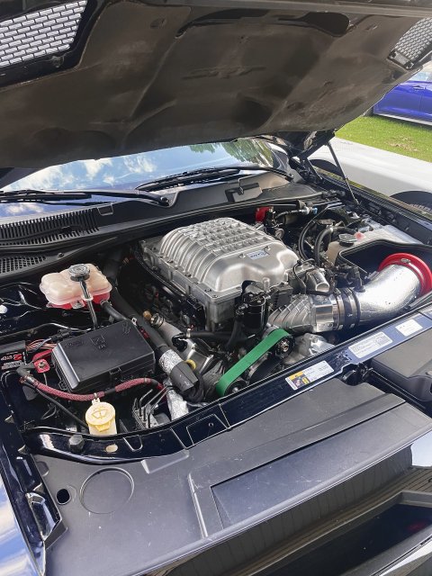

anyway the motor is fully prepped, we have oil in it. Super charger is prepped too. Fresh plates.
Breaking for food then all fluids and then going live on instagram or youtube, yall lemme know, was live on IG before on my acct “shitmyhellcatsays”

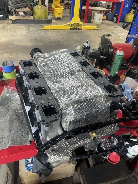

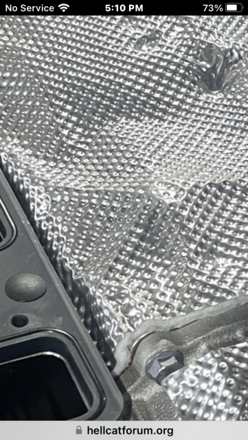

It's hard to tell from this pic if you did it or not, but it's a good idea to cut openings in the blanket where the 2 breathers are on the supercharger.
3,828
9,073
Does not look like it :(
3,828
9,073
@fumanchu182 , need to get them vents open or your going to blow the seals out of your supercharger.
7,679
20,113
YES, just use a sharp object to poke a hole and move the material back around the rounded boss. Easy peasy.

I mean honestly the material is cotton, sure it breaths just fine
3,828
9,073
Ever remove a glued on blanket? Stuff seals like Flex Tape. Send a blower in for repair with a blower blanket stuck to it and they’ll send it back to you or charge you hundreds to remove it and it’s residue left after pealing it off.
Nope, because I’ll never put a blanket on a supercharger. Sold mine, I just use the spacers for sealing

Welp not pulling that blower to make those holes, oh well. I'll deal with that when I deal with that but that blower has been on the car for about a year and some change and hasn't had an issue, with that blanket and yes I have removed a blanket before. Wasnt hard at all. She sounds real healthy!
Best part, no smoke at all. That made me feel great. Following MMX procedure to a T. @Jon-MooredPerformanceLLC has already reviewed the idle log. We are g2g for street driving and finding an abandoned road for WOT. No one in the DMV would let me use their dyno unless they were tuning it. They can pound sand.

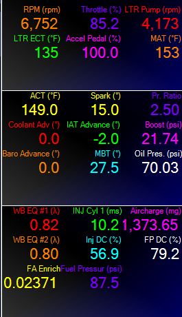

Went and did street pulls. @Jon-MooredPerformanceLLC and MMX have logs. Will make sure we are g2g for next round and then cut open filter per MMX requirements. The car is very very very happy. No smoke. We are letting the engine cool down completely to let the rings do their magic.
In good air I was making at best 21psi. This is the weather right now and above is the boost we just made. ... FUNKING LOL ...
