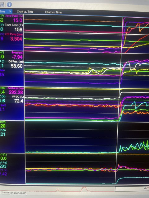

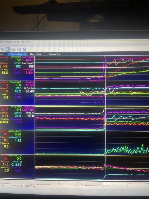

I'm excited for this, here is some math about how slow my launches are. Reaction Time = Vehicle Reaction Time + Driver Reaction Time.
70647547511__AD02E995-11C8-4B0B-BF68-3F88EB71C317.jpeg 70647552957__284EF4D9-AE3A-4A2E-892F-BE1F8FFDC539.jpeg
.658-.118=.540 before the car even moves, dodge etc sucks doo doo
Does the lag time stay consistent? I'm going to say no from my experiences.
4,045
10,104
Thread Starter #1,505

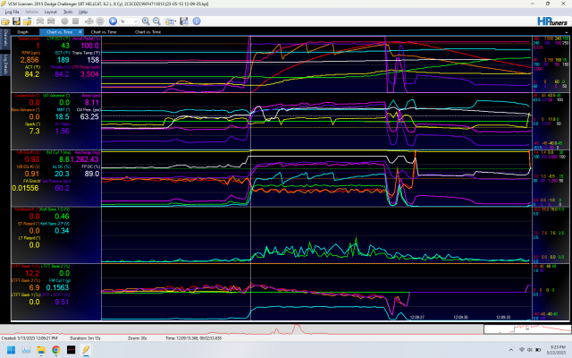

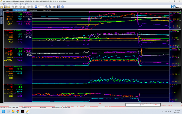

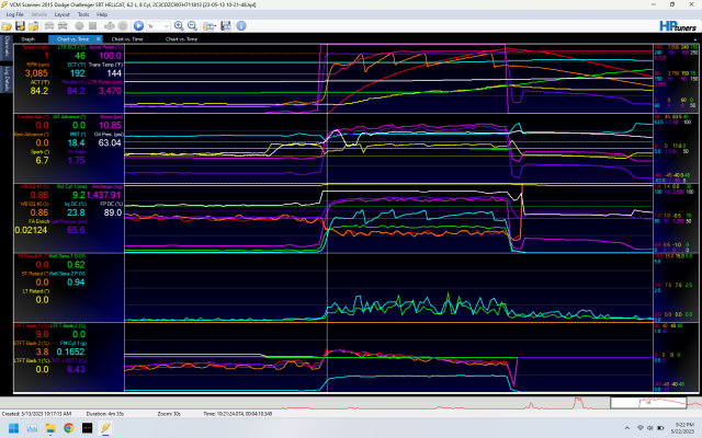

All experiences are different. Reviewed a small sample of my logs.
Three different logs, that gap exists in all three of them. I'm sure I can go back and look at older logs but I'm pretty sure this is consistent.
It always seemed to me that the amount of time would vary. Stay fairly consistent but really lag other times.
But it could of just been me moving slower than usual.

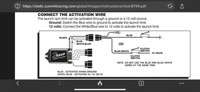

Not sure what you mean? My two step using a stage 6 / msd box is activated with a button I hold to activate it.
