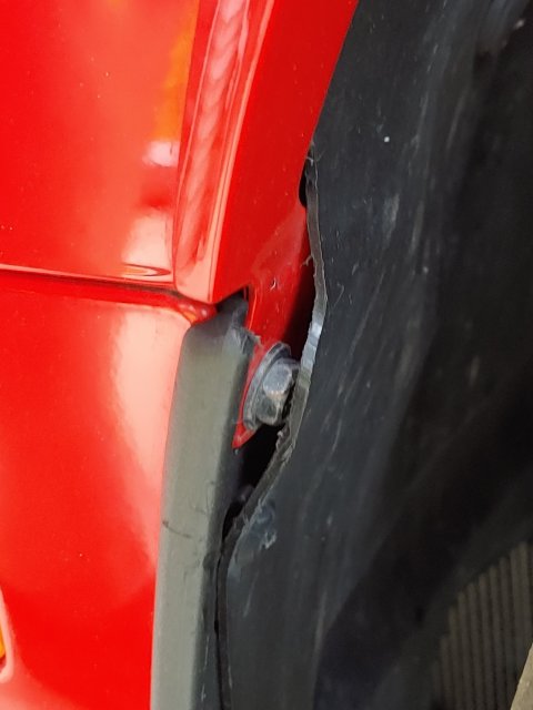

30,480
4,847
25,745
Thread Starter #172

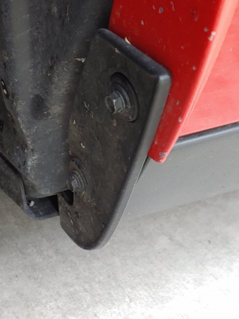

30,480
Rear bolts
4,847
25,745
Thread Starter #174

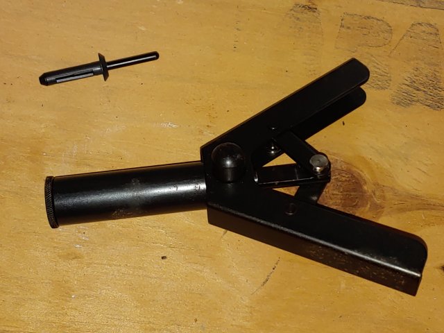

30,480
Tool
4,847
25,745
Thread Starter #176

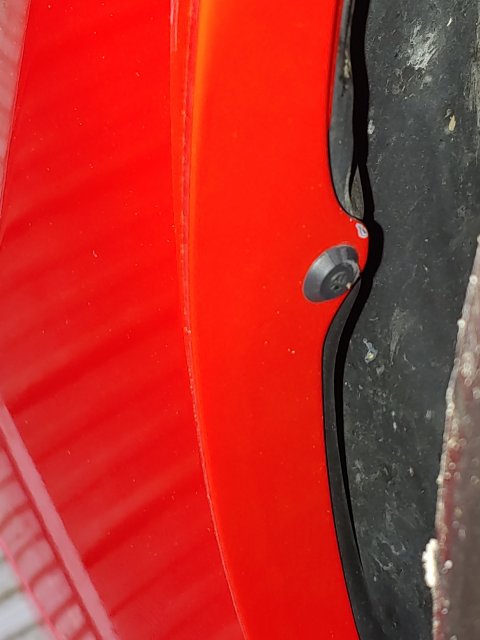

30,480
And an installed rivet.
10,785
30,480
