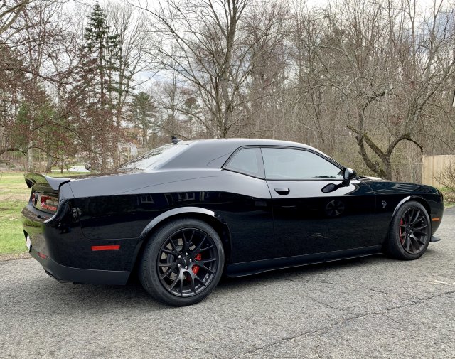

I got around to putting my flares on today and I really like the way it came out! I used the plastic rivet tool technique which worked great. Thank you for all the help and tips. Now on to wheels...
Looks awesome. I used the plastic tool technique also. Thanks @Hunter .
awesome looking flares...now..you stand out
