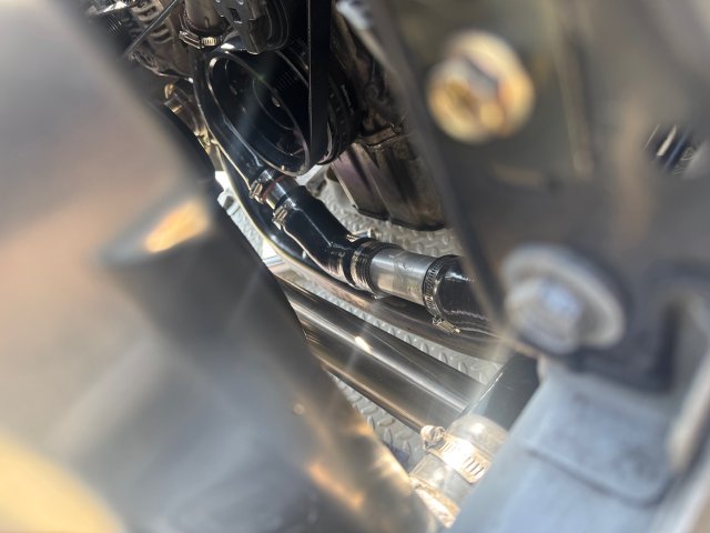

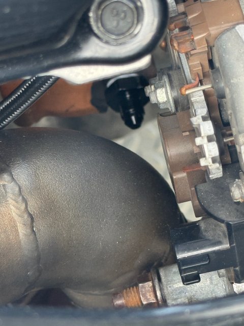

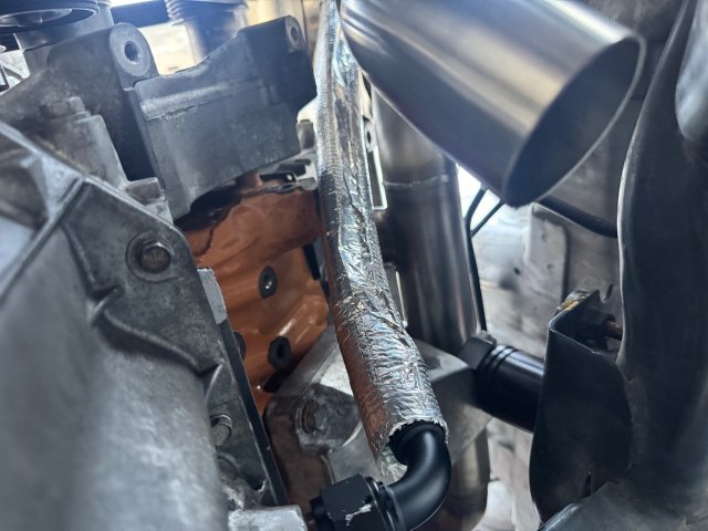

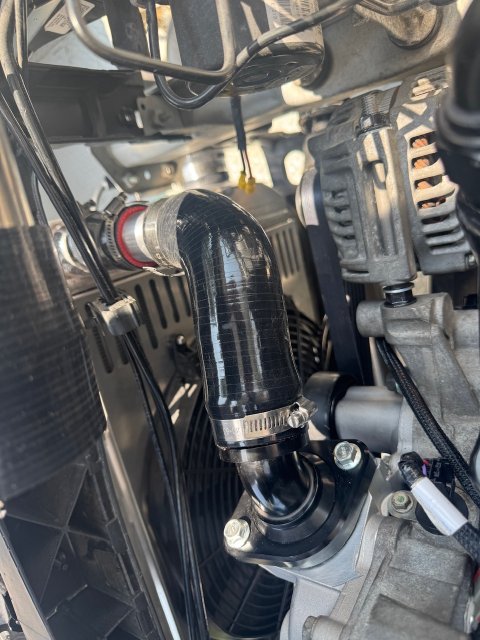

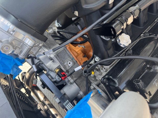

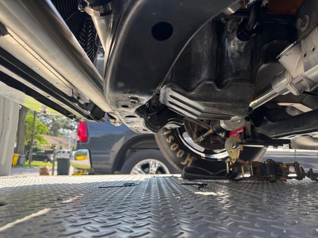

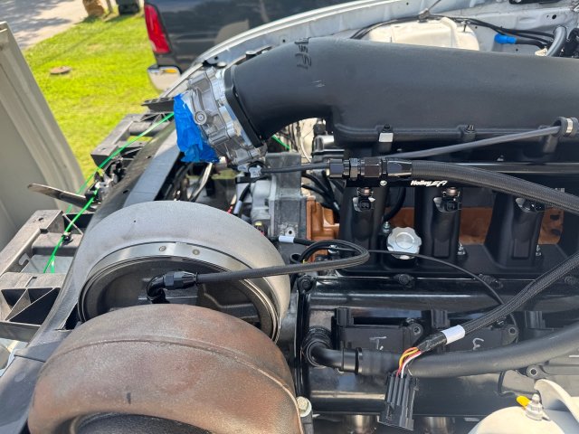

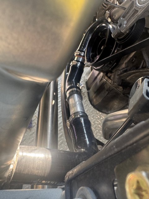

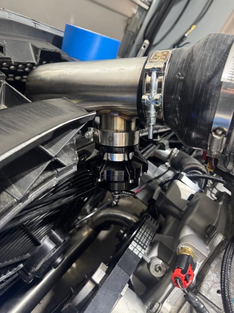

Good progress starting to look like an engine bay coolant system and oil systems are sealed. Waiting on new map sensor and a dome sensor. Then I can plumb the turbos, write a config to Holley and get ‘r done.
IMG_7213.jpeg IMG_7214.jpeg IMG_7215.jpeg IMG_7216.jpeg IMG_7222.jpeg IMG_7224.jpeg IMG_7226.jpeg IMG_7240.jpeg IMG_7239.jpeg IMG_7238.jpeg IMG_7241.jpeg

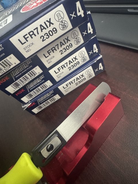

Because my friend Jon hasn’t texted me a better plug. 😭
4,117
10,339
Thread Starter #768

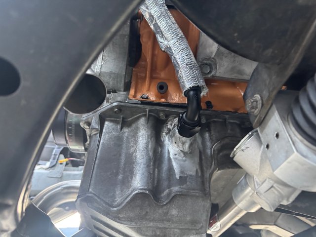

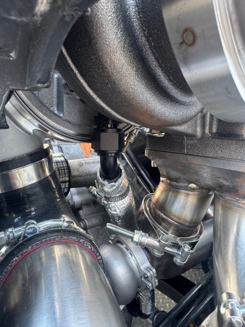

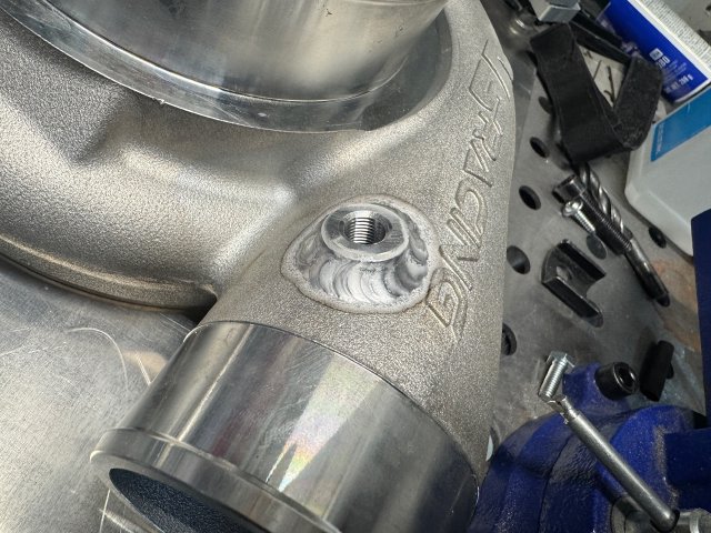

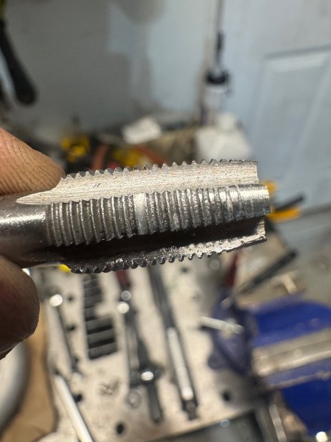

The things they never mention in the instruction manuals. Man building a turbo car does have a learning curve 🤣😭
18,697
98,599
4,117
10,339
Thread Starter #770

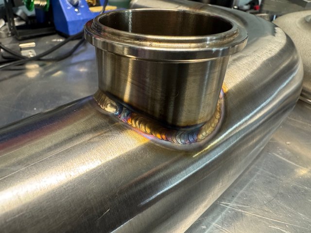

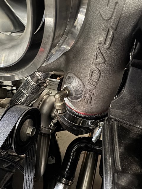

Nice looking welds. I remember your learning thread.
Oh hell no, took these to a real welder. I bungled the npt threads cause god hates me, npt tap galled up and well infinite spins

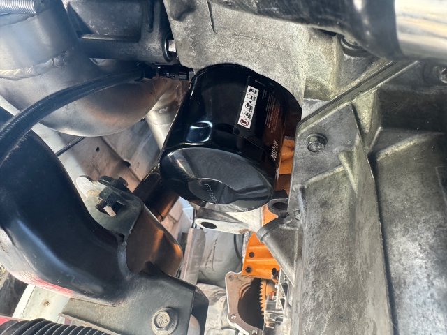

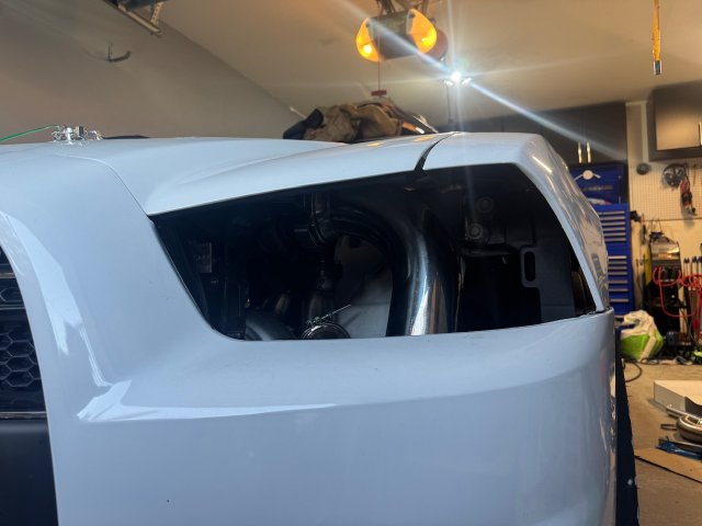

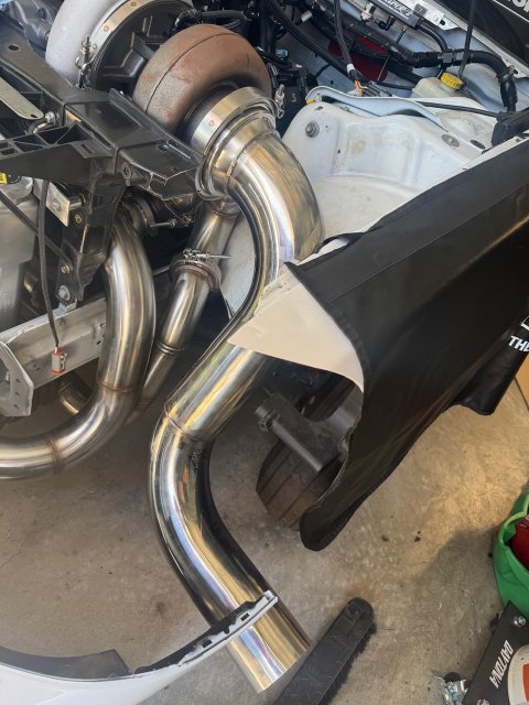

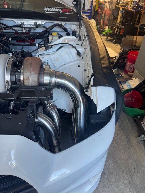

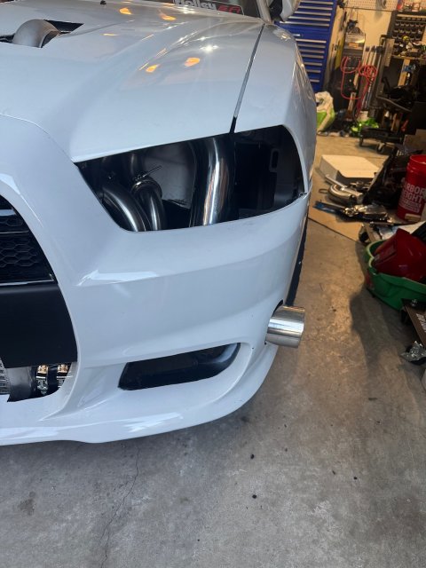

Shin destroyer 9000
its going to get a vband so I dont have to take the exhaust off to take the bumper off.
