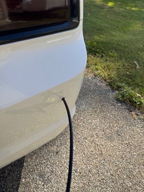

Woke up the dead this morning. Winched it off the trailer, parked the trailer on the side of the house… then all hell broke loose. Got 4 text messages from neighbors…

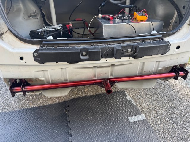

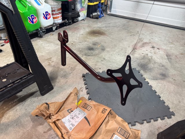

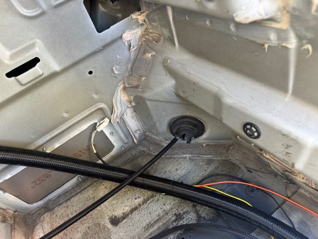

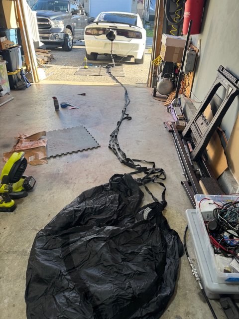

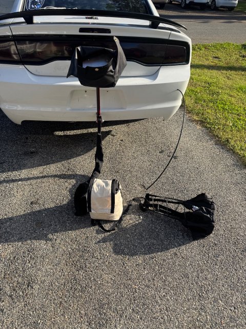

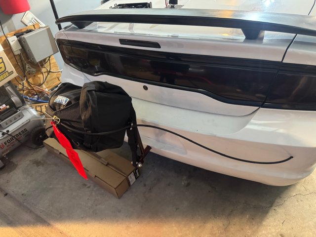

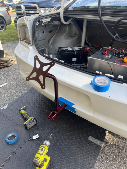

spraycan metallic red is my new favorite
Chute mount is from Tim at MAF
https://mafracing.com/products/challenger-parachute-mount-15-24
I am a Charger so some r&d to see if it would even fit. Expensive gamble if it didn’t 😂
It fits way better on the charger than the challenger. Hellcat tax still stings though will never understand why same fabrication parts are hundreds cheaper for mustangs
