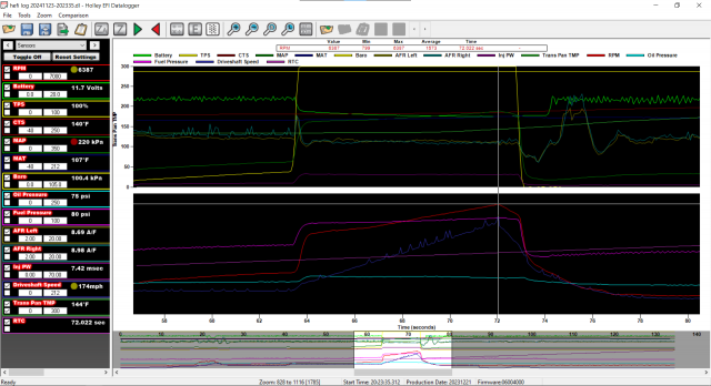

4.) When I went wot wot on the dyno pass the car simply does not get hot. Good problem to have, bad problem for my oil. I will try and let the car idle more, even without turning on the IC pump, and fans it still takes about 15 minutes to get up to any temp.
5.) Holley gen 3 hemi harness does not have a oil temp sensor, the oil temp sensor has no public data so I'd be left to put in a holley or low-doller sensor and keep tabs on it if cts was only 140 in this pass, oil was probably just as cold.
Also peep that drive shaft speed sensor... it's doing it's thing!

Also that MAT temperature is taken from the front passenger TMAP sensor. No ice.

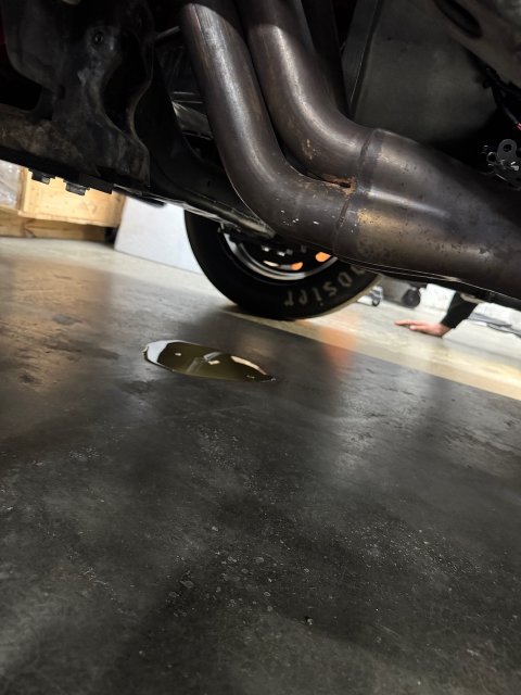

Well guys, may we have a moment of silence. RIP Hellcat block 2015-2024. You set the world ablaze one quarter mile at a time and owe me nothing. May Jesus smile upon you. I haven't pulled the block yet as I'm trying to ascertain what's next if there is a next. I may decided to put a LS motor in it. (this is not a joke I'm dead ass serious, I can get a 427 turn key for less than a hellcat longblock.). I may also just build a 458 stroker and go NA.

No!!! That sucks man I’m sorry to hear it. Guess there’s a hole in it?
There is no hole in the block. There is a crack in the pan, the pan can be re-welded, will know tomorrow if the engine is salvageable, beginning teardown at 8am.

Good luck man, hoping for best case scenario. Maybe rod let go on the downstroke. It it shut down? Did it bang?

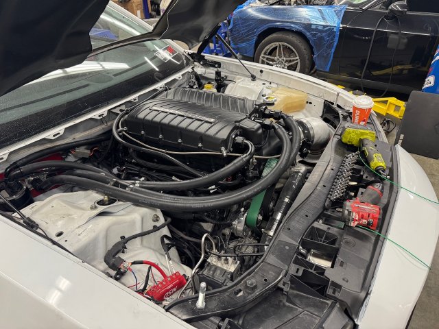

Go big or go home, blower is Absolutely fucking trashed, rotors are locked up.
2025 is not happening, may pivot to just making a bracket car. Sit my ass in 12.5 index and just be happy to be alive.
