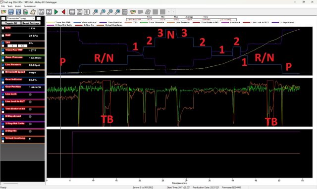

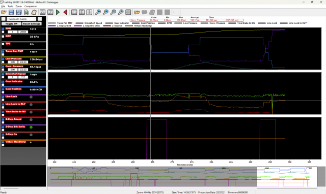

Thread Starter #645
Still getting jiggy with it. Might have a private rental on Monday

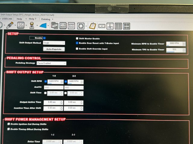

Holley has a new transmission ICF I am learning to tune.

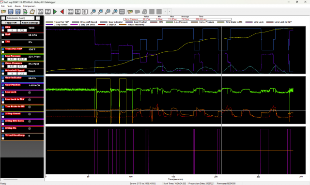

Filmed like a potato on this one. Good news 848hp/752tq.
Bad news, possible boost leak. But hey that's part and parcel for building a race car.

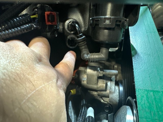

Think we found the boost leak. Lets just say my brake booster is probably feeling some way…
pulling vacuum from here
well thats a runner post rotors will all the spicyness and its going to my poor brake booster. Would explain why the brake reservoir cap is always seeping… im going to pull vacuum from here…
just waiting on some an orb fittings
8,694
7,652
Brakes must have been tight 😆 yeah, pull from the intake track on the snout if possible. my 4.5 whipple had me take the vacuum from the back of that hideous rear intake elbow pre rotor

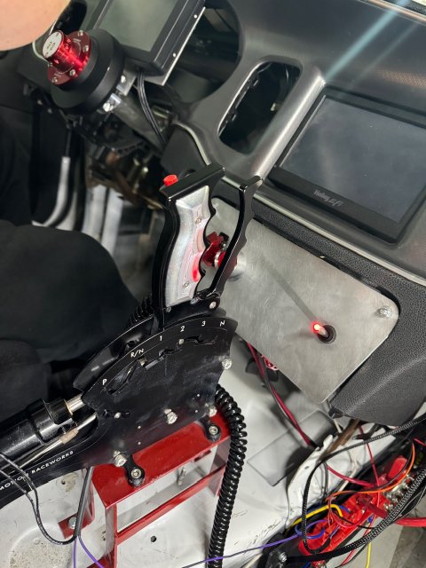

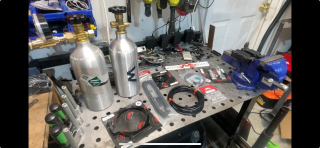

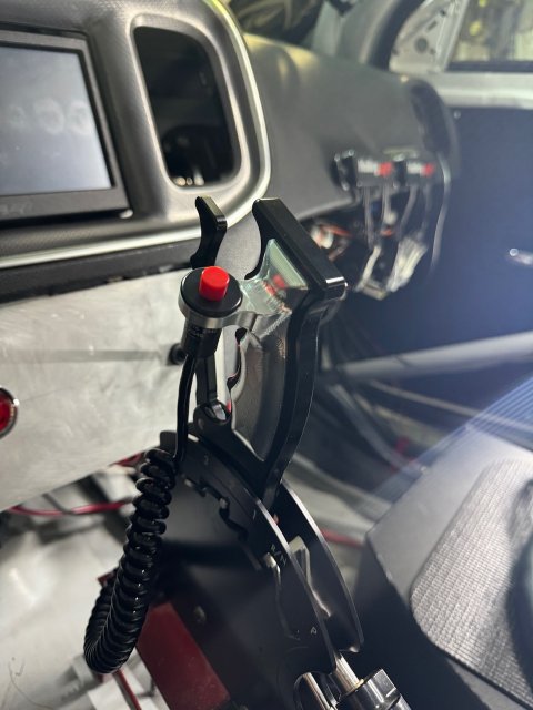

added some bling, also have decided that since I have co2 i will be using the transbrake as well, will be testing on the dyno soon.

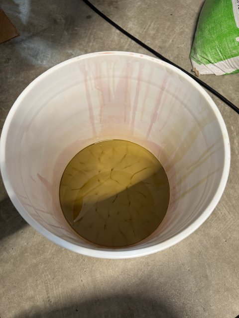

First oil change.
No I don’t have a headgasket leak. E85 contamination. Catch can was bone dry. Might need to change that.

Wow what caused that?
4,117
10,339
Thread Starter #659
Many factors such as worn rings or potentially too long of a line for the can
7,490
19,688
Isn't the motor new or am I lost in the thread somehow? I'd suspect too much injector or something.
