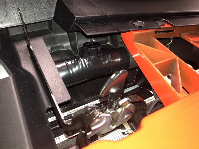

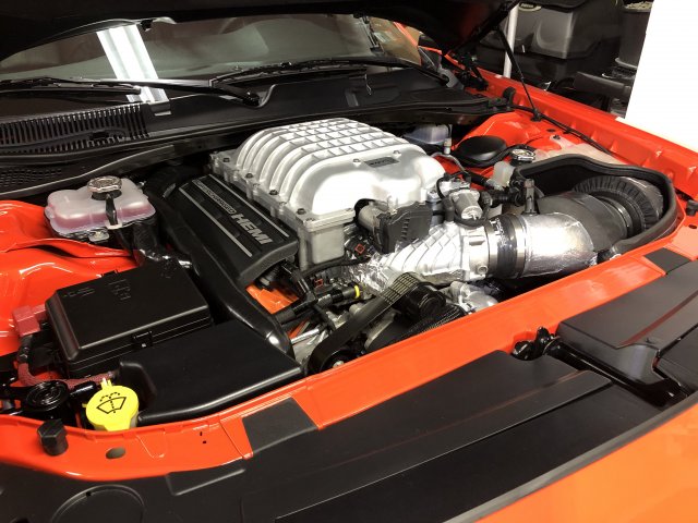

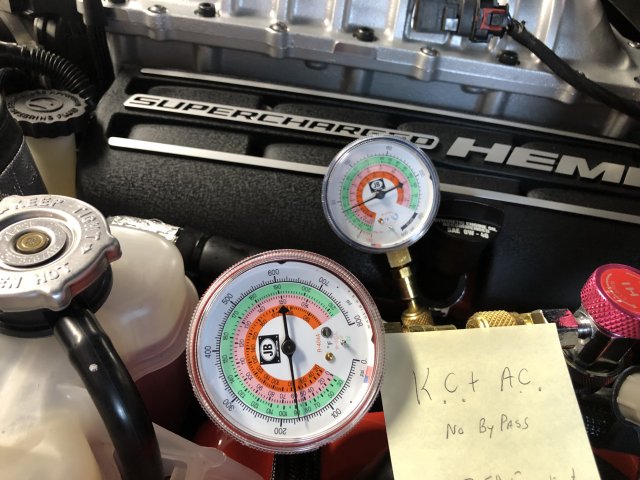

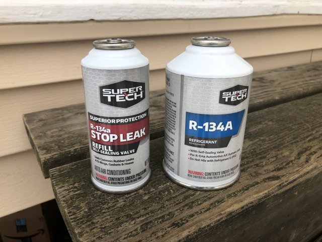

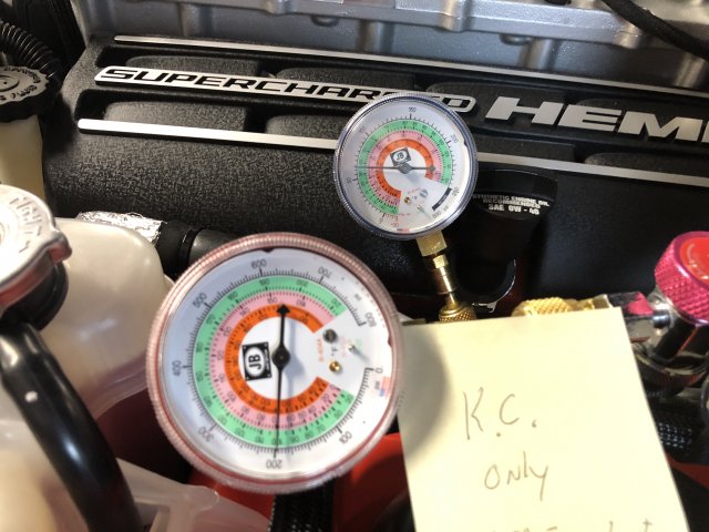

The AC compressor did not engage until system pressure came up to about 25 or so lbs, about the first can or so. I added the can of oil charge and sealant mix after the compressor started to spin. I purchased the Freon and oil/conditioner charge from Walmart. When running the system burp air from Tee fitting and also from brass bleeder valve on back of super charger where the coolant hoses go.
Edit, charge with can upright until compressor engages, that way it’s all gas, turning can on it’s side or upside down will induce liquid Freon which isn’t good for the compressor to start on. Once compressor is spinning then charge in a liquid state, can on it’s side or upside down

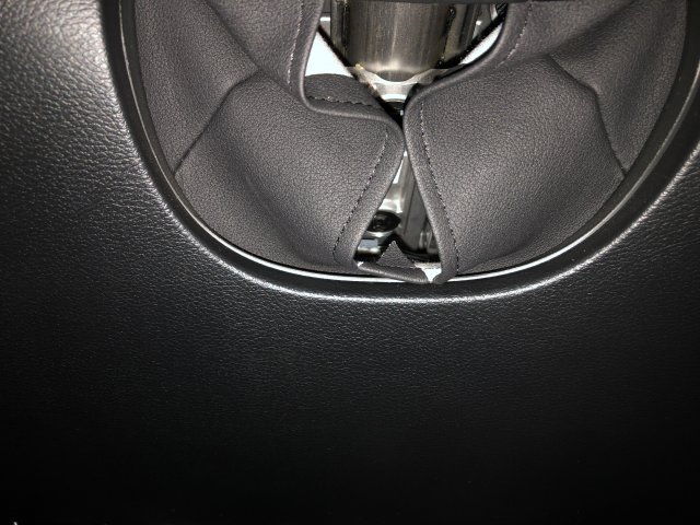

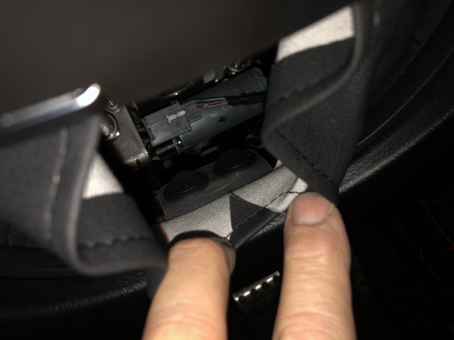

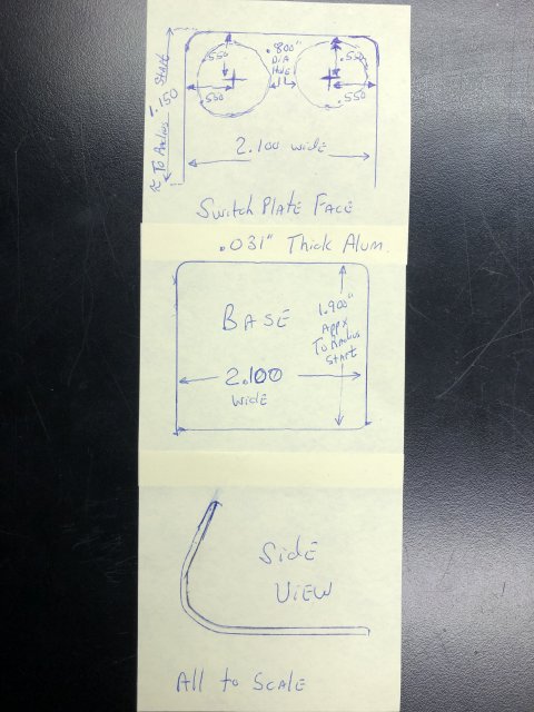

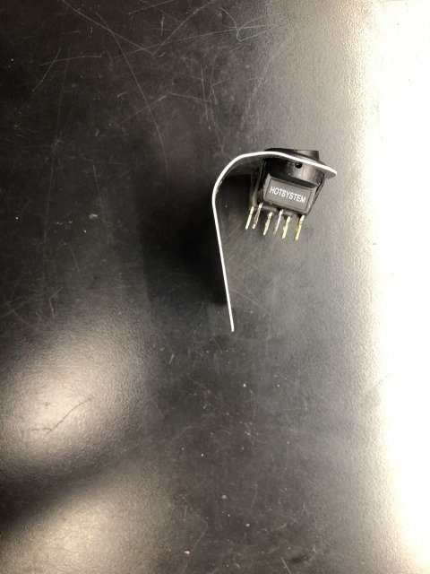

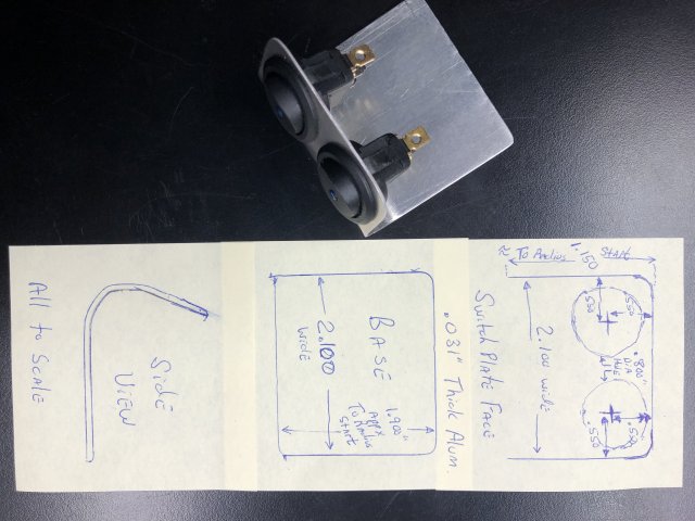

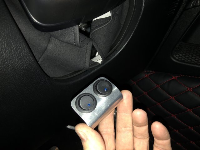

I’ll post some more pictures later of how I got wiring into the cabin and switch plate I made up for the Drag Valve and Heat Exchanger Bypass valve switches. They ended up right under the steering column inside the vinyl trim boot, no drilling screwing sticky tape or nothing to mount them, hidden but easy to access and use.
