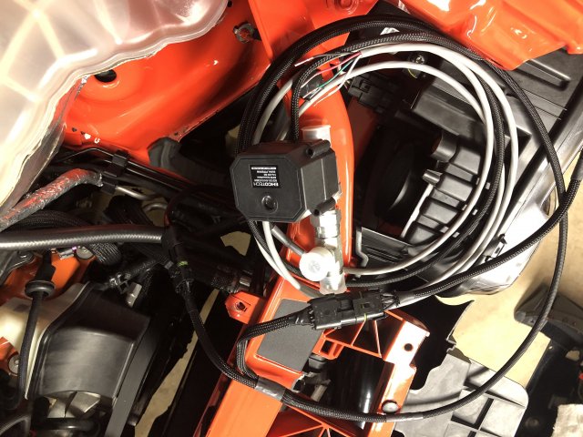

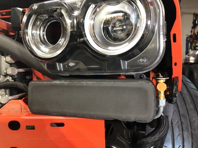

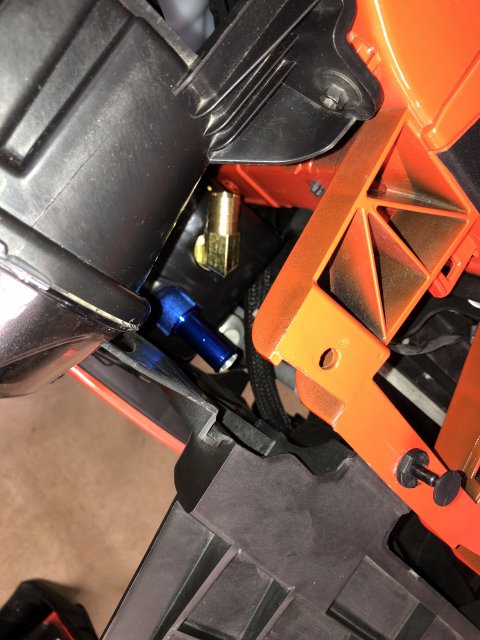

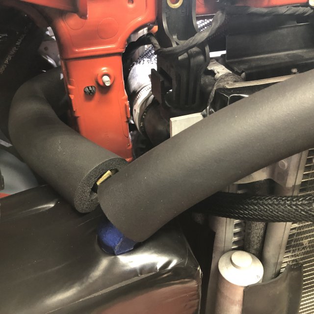

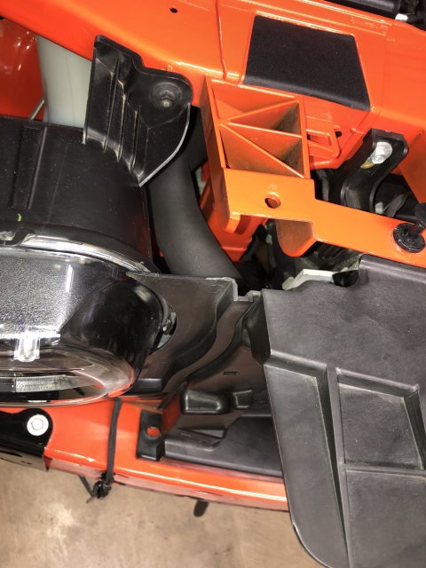

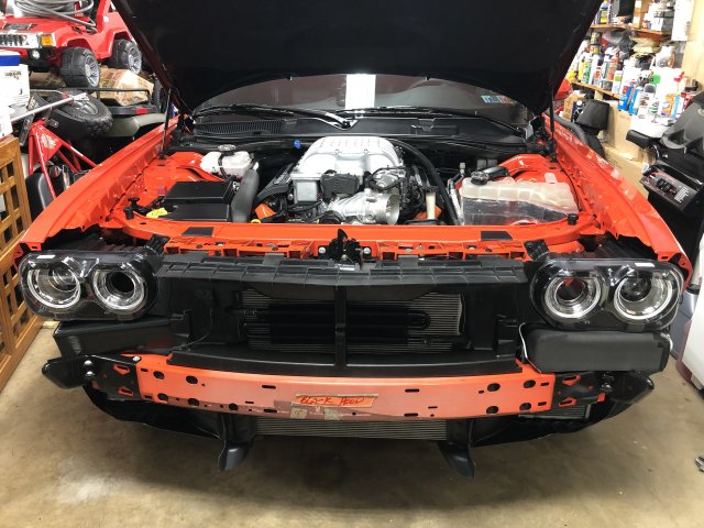

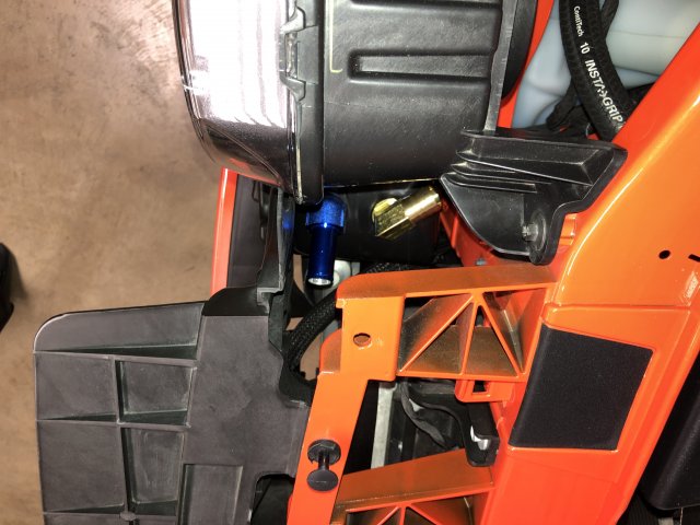

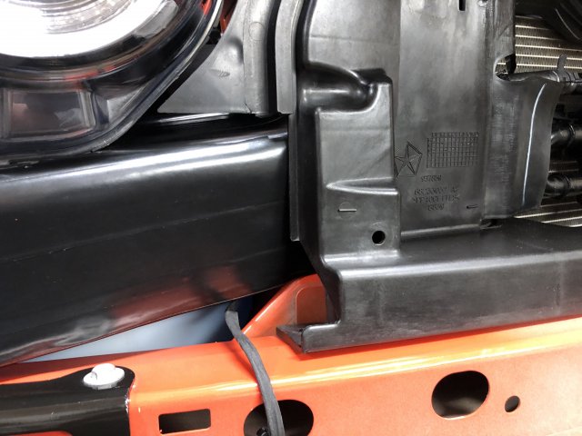

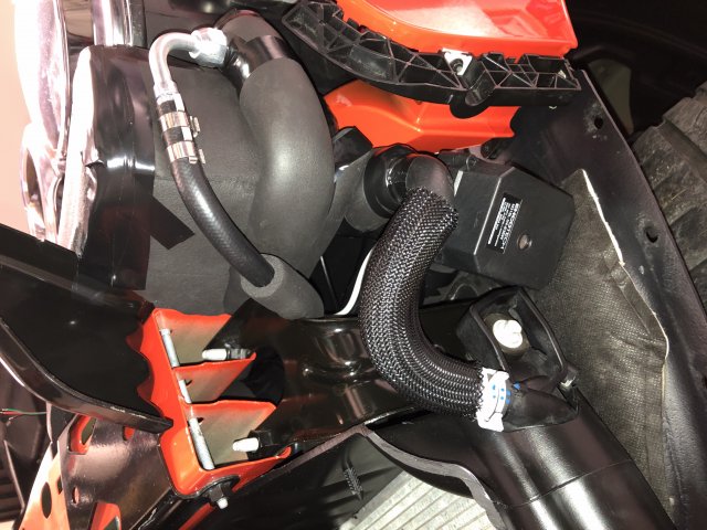

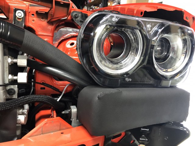

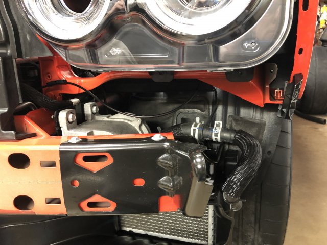

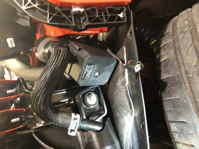

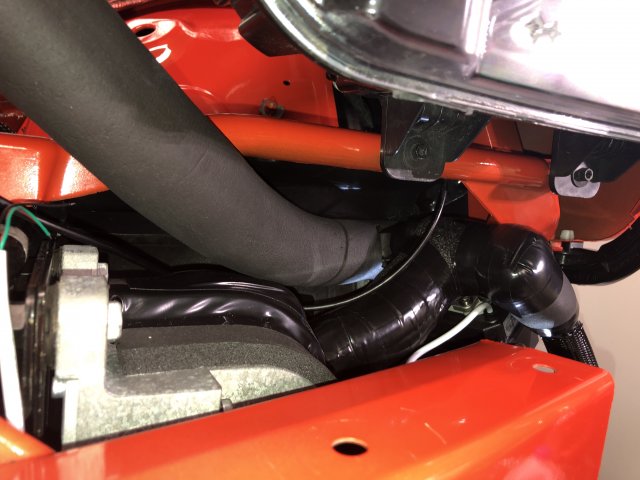

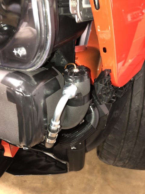

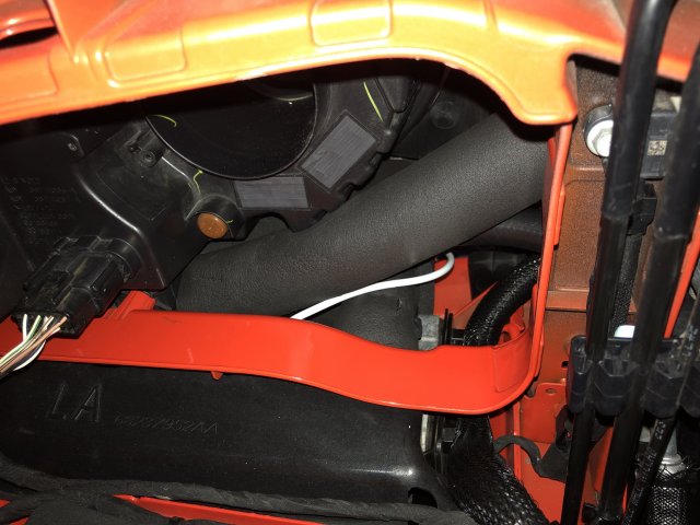

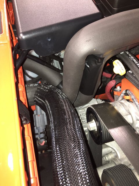

Insulating to the degree and neatness I did took easily twice as long as putting the parts together, it was a process and a toil trust me. It’s insulated like that right back to the pump inlet, pump, valve to the unit. Under the headlight and behind the number facial it all hides. Even this slick bleed Tee right under the hood latch cover.

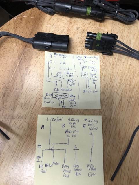

The KC idea,,, wonder whom came up with that idea a year a go??? HMMM. Wonder wo tat chiler mechanic from Florida is?? HMMM. Now question on your 3 way valve. Set up control wise. Is it in mixing mode, different tempts preferred, or diverting?? When not in operation is the valve normally open or closed for freeze protection ???
3,572
8,429
Thread Starter #29

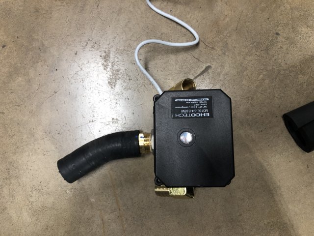

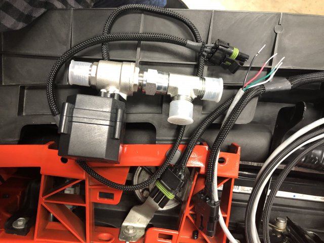

The 3 way valve is either in a position to direct flow out of the KC to the storage tank or through the radiators.

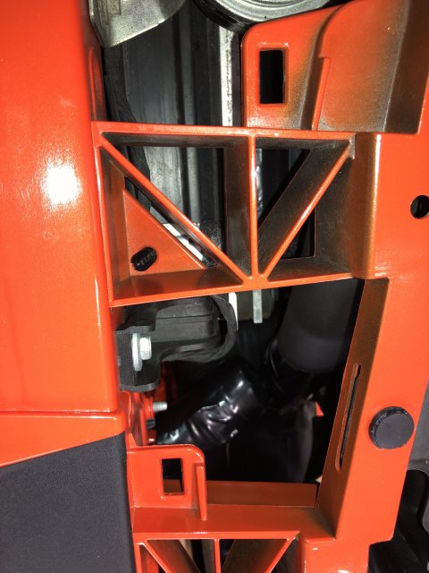

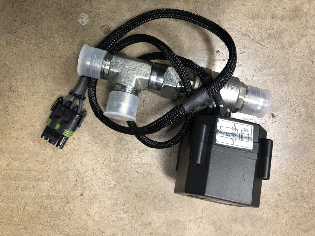

Here it is before being insulated and then picture installed 4B63D5D8-91A1-48AC-BEC2-80A5541F7D9D.jpeg 342E1714-FB39-4C49-A0BA-8B7EC01C2D01.jpeg 66273D5F-6C98-4674-9F0C-82706316AC0F.jpeg

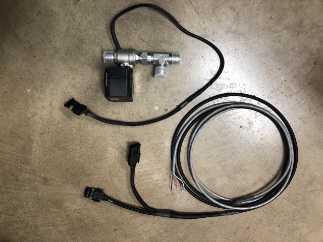

The Drag valve is another motorized valve but is just off/on and located in the suction line under the air box. I insulated it to protect it from radiant heat
73F9B06C-241F-4E76-9AAA-668BD89902A6.jpeg 0E090199-8D0A-4E55-AE09-844DB34994A2.jpeg
