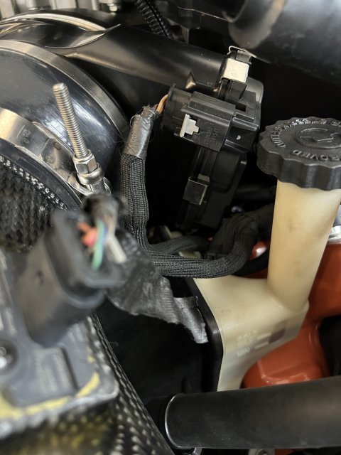

On 3.8L, The big throttle body motor hits the power steering reservoir on cars that still use hydraulic power steering. You’d have to come up with a solution for that like remote mount the reservoir, convert to electric power steering, modify the stock plastic reservoir, or whatever idea you can come up with that you can implement.
I have the Nick Williams 130mm TB on mine and the stock reservoir clears it.
If you flip the TB to face the motor away from the rail, I would imagine it does. My hood doesn't clear it though.
It’s close, but fits. Does your 3.8 use the stock By-pass or is it the race version?

Yea, mine didn't clear, not even close, nor did it clear for many others I tuned. Perhaps they adjusted the adapter plate design to clock the TB differently so that it does after receiving feedback about it.
Yeah that’s the likely scenario.

I made a remote reservoir so I have a plastic one if you need
I’ll buy

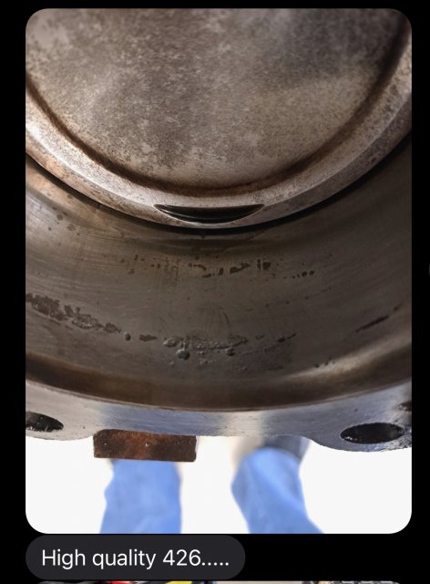

I might have found a great deal on a 426 rotating assembly. Just waiting to confirm the pistons/rods etc. I am also waiting to find out the cam specs, but am thinking of going with an OST Demon Plus cam and Thitek heads. I have finally been convinced to ditch the factory electronics and go Holley dominator EFI, and we will be throwing a TH400 in it at the same time. I will have to figure out what trans gear ratios and which rear-end gear to go with. This was basically year two of fighting with the car the whole year so it's time to simplify the situation.

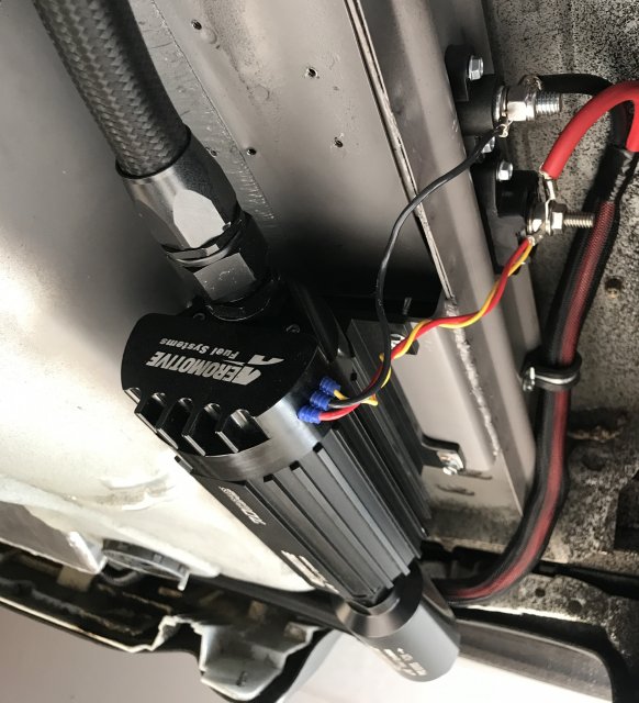

Thanks Marc, I appreciate your insights as always. With the Holley are you running a factory style pump or did you go with a FueLab/Fueltech type setup? I am leaning towards that and just having it draw from the factory straw.

I have a 12 gallon fuel cell in the trunk that has a sump. That was necessary due to the 4-link requiring the removal of the stock tank. I have the 8 gpm Aeromotive external gear drive pump. No reason the Dominator won’t work with a capable Fore system. Also no reason you couldn’t dump that heavy OE tank and go with a light weight cell. EE1E65C7-FB3A-4AC9-B2C4-C241554A573A.jpeg 30D3BE55-6C64-4A9A-BCF8-A5124BF18098.jpeg C53401E1-06E9-4141-BCFE-72453C5518D5.jpeg 5F735AF8-8419-4685-9EAF-E27ED0D1BB53.jpeg

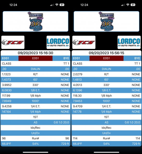

Well, it's been a while since I have been on. I finally got the car to run somewhat where I thought it should be.
Ended up with a best of 9.42 at 147 after throwing the 3.5-inch pulley on it. I think the 3.5 finally gets the Whipple 3.8 in its efficiency range as the 4.0 to 3.75 barely made any difference, and the 3.75 to 3.5 was worth 3 MPH and almost four-tenths.

I did mention that it looked like I had a 426 shortblock for the car a few posts ago. Upon tear down it was no bueno so I’ll likely buy a rotating assembly and have my block machined.
