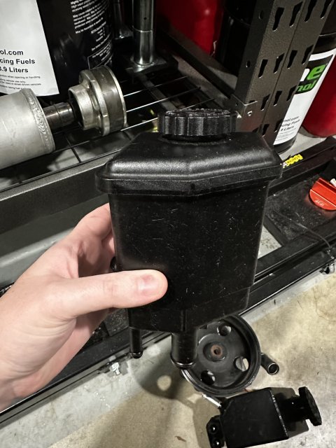

Here’s one solution. This pump is for sale as well (2015 challenger hellcat pump with fitting for remote tank)
8,670
7,638
#75

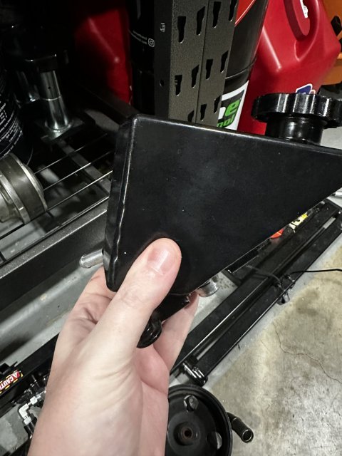

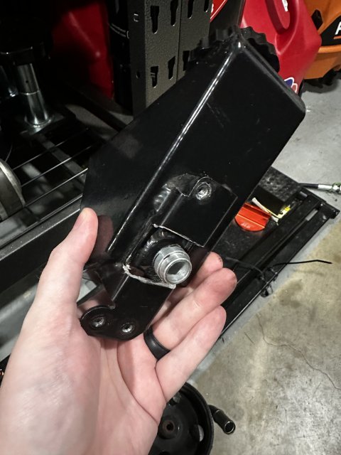

I also have a metal tank from a whipple 4.5 that bolts to the top of the stock pump, you reuse the mounting bracket from stock pump/plastic tank. just needs an o ring (I have some laying around)

Also have a remote tank for sale:

#77
View attachment 113395 View attachment 113396
The reservoir cap on the metal tank needs to be relocated to the other side for that to fit.
8,670
7,638
#78
Good to know!
