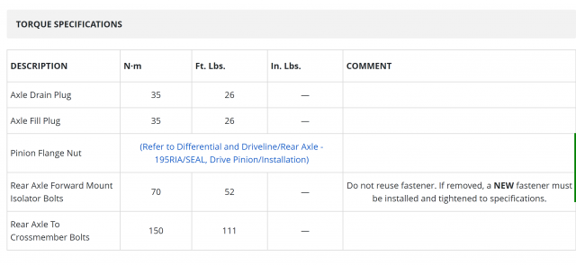

Considering I cannot get a torque wrench on them on the rear (one's through cradle) gud-n-tite is enough with some blue locktite. For the top in which you can get a torque wrench on them:
Thank you sir, my manual says less for the “forward mount”. The ones that are 52 ft lbs, those are the ones that can be gotten to with s torque wrench, correct?
