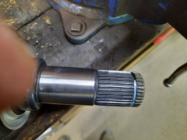

is is my stock broken axle that I removed yesterday, twisted
Yikes, year/miles/whp? Mine look straight as an arrow
I ordered this car in 2015 got rolled into a 2016 so was a early 16 build, has about 7,000 miles on it.
its got a built 411 with 3.0 whipple. car ran 9.33 at 147 with stock 2.4 blower 1.38 60 ft.
been to the track once since whipple installed an snapped L.side axle. I knew is was just a matter of when, not if.:sick: I have a wavetrac an outlaws to install. will soften up the launch so not so hard off the line.
3,624
11,682
Something to consider…. The 3.70 gearing with the resulting wheel spin was taking the pressure off the driveline. Spinning the tires is like a pressure relief valve. The taller gearing and a harder hook due to less gear will put more stress on the axles. Don’t be surprised 😂
