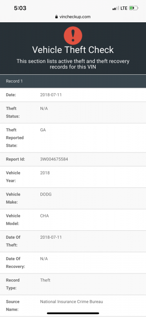

Demon 2074 was reported stolen on 7-11-2018 out of Georgia
You a better detective then I. I have been searching the same thing with no luck so far
