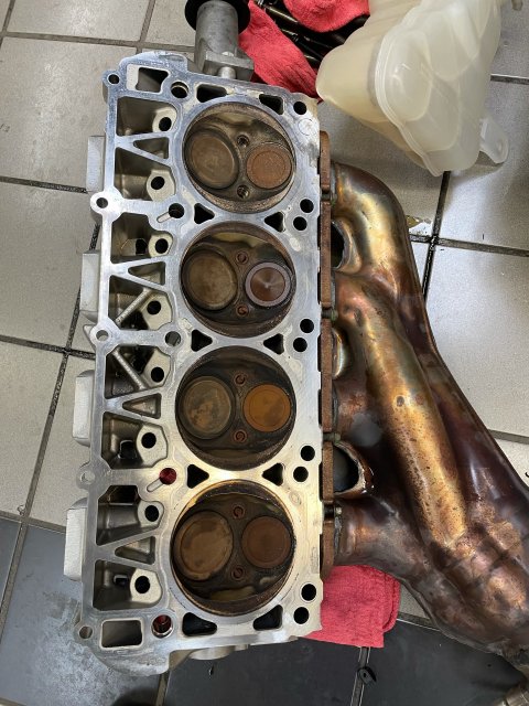

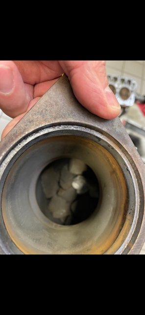

Picture of the inside of heads from several tanks at the track (road courses, not 10 second runs, but 15-20 minute repeated WOT use), and some prior street use with 93 octane with and without booster. These were frozen in time after an engine failure, so it did run laps the previous day on a mix of racing gas/93, and a mix of Octanium/93. Try to ignore the metal shavings showered all over, that is from supercharger blades that seemed to disagree with each other at about 5200 rpm in 6th! Some of those valves are filled in, some are not, some of it is tainted orange. But, here is what they look like just plucked from battle. Engine had about 11,000 miles on it. The cause of the failure was a plugged left cat converter that is also pictured below.
I used Octanium off and on on the street and at the tracks in this engine. Because of a few recommendations, my new friend is Boostane and when available I will use higher octane gas to supplement my octane rating when lapping.

Sorry that happen @DGatzby, I'm no expert on judging this from a pic but it doesn't look that bad to me, as far as the color & residue.

No, I agree. With a few of you getting ready to pull plugs, I wanted to share. I never poured more than a half a bottle in a tank.

If you pour multiple bottles of octane booster in at a time or use it everyday it will build up over time ... But will disappear eventually once you discontinue using it ...
Using it from time to time and then logging lots of street miles will get rid of of pretty quickly ... It's not a substatue for race gas in my opinion. I would rather use it in a pinch to error on the side of caution then not use anything and have an issue ...
It's not much different then leaded gas leaving a white residue on everything...
For what it's worth a tank or 2 of E85 will clean it up in a hurry lol

So the Cat failure was b4 recall ?

I don't think his year had the recall
