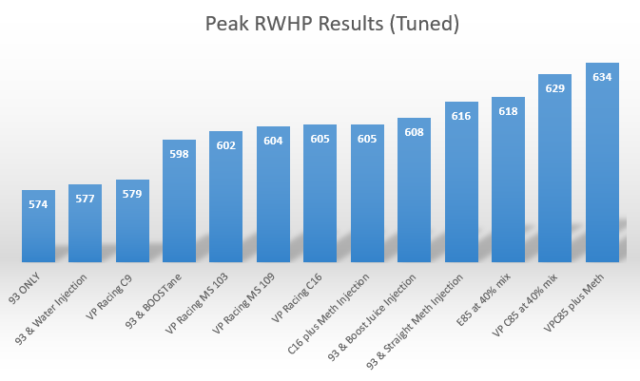

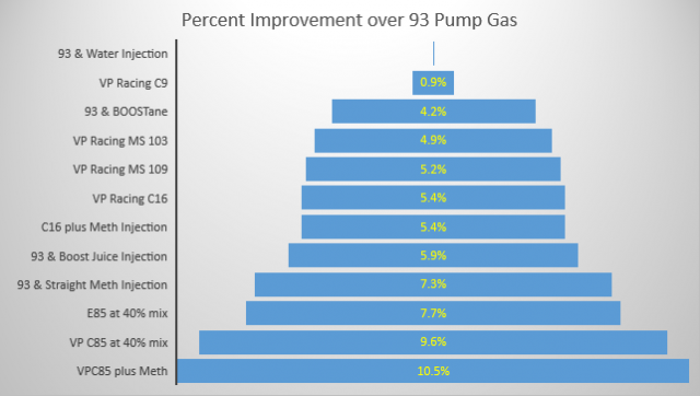

Since your post here pointed me towards this particular rabbit hole, I've done a little digging. Came across this series of articles from Engine Labs from 2017-2018.
Interesting set of results from the end of their testing...it seems there's very little improvement from 93 octane + an octane booster through C16 and Meth injection in terms of RWHP gains (see picture below; links to articles at bottom).
Granted, their test vehicle was a blown 'Vette, but as I've come to learn over the years, if @Speedy! suggests something is worth doing to protect one's vehicle, them I'm going to look into it and do it.

Interesting that on the chart that 93 + Boostane is only 1% lower than MS109
Read the second article (2nd link I posted). They come right out and admit their findings would "light the internet on fire), but confirm that their test results were solid; 93 + an octane booster performed comparably (and far cheaper than) the MS109 and others, up to the point where they introduced methane injection.

I have seen those articles before and they have some good info, but miss a few things too.
An octane additive "should" perform the same as a race fuel all other variables being equal. If one could be produced that didn't leave deposits it would be a great option for the weekend racer. I didn't see the deposit listed as a con for the octane booster, so perhaps the author(s) weren't aware, and those articles are 5 years old as well.
They stopped E85 at only an E40 mix. They still gained a lot and beat out race gasoline, but had they continued and had a fuel system to support full E85 imagine how that might have looked. My flex fuel tune doesn't even start upping power until E40 and then only marginally, and it continues to add power until full E85 is detected. In my track testing E85 is doing quite a bit better than 109 octane race fuel as well which makes sense as the extra fluid volume's cooling effect and add'l compression it provides makes torque.
I also notice their tests started to peter out around 23-24 deg of timing. Makes me wonder if they were approaching MBT for that engine combination. Once you get there adding more timing won't make more power regardless of what's in the tank.
