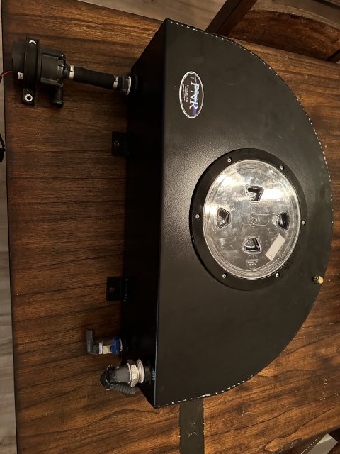

IMG_0905.jpeg Welp, no going back now. If anyone has any suggestions or advice on routing/t’ing the coolant lines I’d really appreciate it
