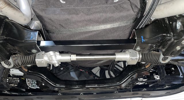

guess redeye pans have updated baffles? I’d be curious to see the inside of one. @Marc W, you have a different k member up front for the rear sump pan right? Manual steering?
3,633
11,720
#56
I

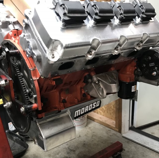

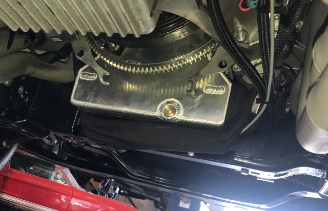

My current setup doesn’t really apply to what anybody else here is doing. We experienced a drop in oil pressure thru 1st and 2nd gear on the track with the stock ‘16 oil pan. Some of that is probably just due to hard acceleration with the early pan but some may be due to the front coming up so high with our setup. Moroso has a rear sump pan that addresses this and after changing to that, the logs showed no loss. That pan requires some modification to the stock crossmember, but it’s not really a big deal. I change oil after every time at the track and having the rear sump with the drain plug at the rear is huge convenience with the diaper. Don’t have to do anything but pull it down a tad and… done. 😎

B16D8DC5-B101-4E22-8CE8-EB8228C1CE8E.jpeg FB4AB021-6FEF-4513-BFC1-3DC50980A758.jpeg 5FFAEABE-FD69-4AFA-9BD7-D9BB27D29910.jpeg I run 6 qts in this pan. But like I said… I change it every every 5 miles or so. 😂
