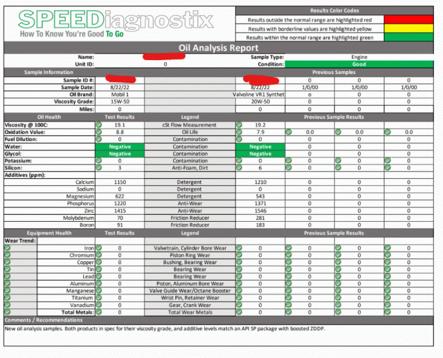

I run E80-85 100% of the time. I send my oil out to Blackstone for analysis and it never comes back with fuel in the oil but I do notice the longer I run the oil my oil pressure drops about 5 psi at WOR, change the oil and it back up to 70-72 psi at WOT (maybe 1000 hard mikes on the oil) Something is thinning it out. Blackstone oil tests do not show a viscosity problem either. This next oil change I’m going to try Mobil 1 15W50 verses the 5W50 Amsoil Signature Synthetic I’ve been running. Mobil 1 15W50 tests very close to Valvoline VR 20W50 at 100 C but has better cold start flow abilities as the VR is like syrup when cold.
