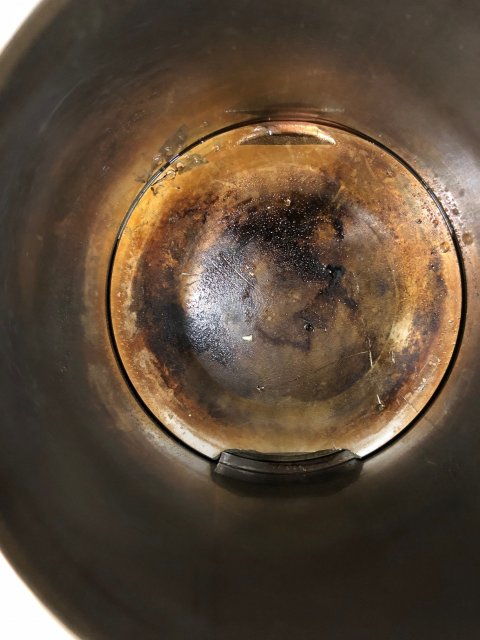

On the 5.7 and 6.1 HEMI platforms (and especially the 6.4), the ring lands were a problem. .
I can attest to to 6.4 ring lands....

Was this on a stock engine, modified, with or without boost?
No boost. Just ported heads, long tubes, cam and tune. Stock internals.

@Stl376 - that looks like the exhaust side of the piston. From memory I think it was usually the intake side that broke on supercharged applications at least. Looks like in your case it just got the ring hot, probably from running a bit lean.

@Speedy! I agree.
