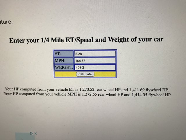

Wallace Racing Calculators….. mph at the finish line is most accurate as the et is affected by starting line performance (60 ft) where as the mph is not. Density altitude affects hp and consequently on track performance, so these calculations are a picture of that time and condition. Not a one time shot like a dyno pull. 655DF604-2E59-4216-B2C9-C6D173612D6A.jpeg

I used this to calculate how fast I was going to run in the 1/4 before I took the car out and it was pretty accurate, I used their other calculator
