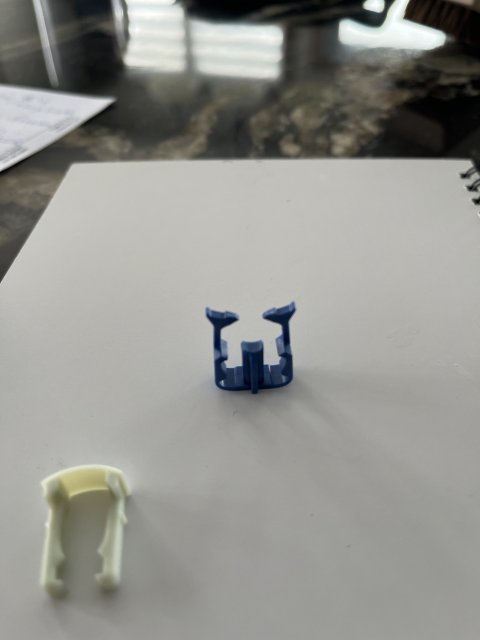

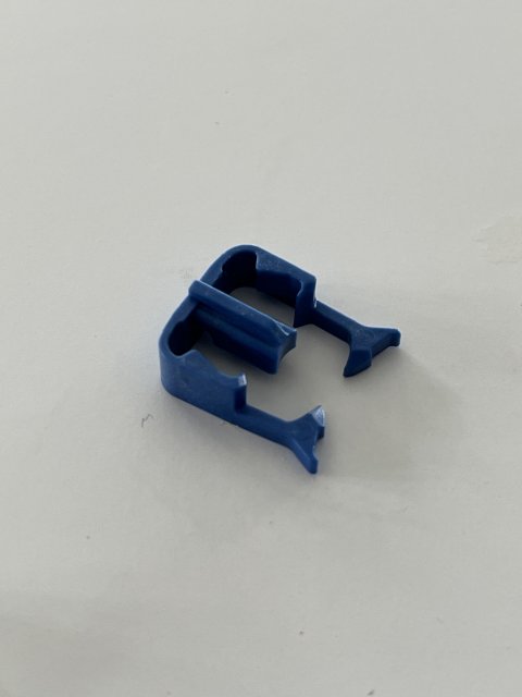

My fuel clip showed up today from Aliexpress and it didn’t match the photo on their site and did not work, I guess I will find out how good the return/refund system works there.

Well the fuel clip showed up from Amazon and it appears to be the correct one. $30.00 for a little bit of plastic but cheaper than the $150 Dodge wanted for the full line. IMG_7713.jpeg IMG_7716.jpeg
