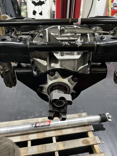

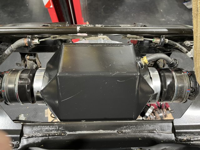

Did you look closely at the picture?
There is actually more to this kit than I initially thought.

I am not sure why the photo only comes up as an attachment ?
Let me know if you can still view it or not. View attachment 174900

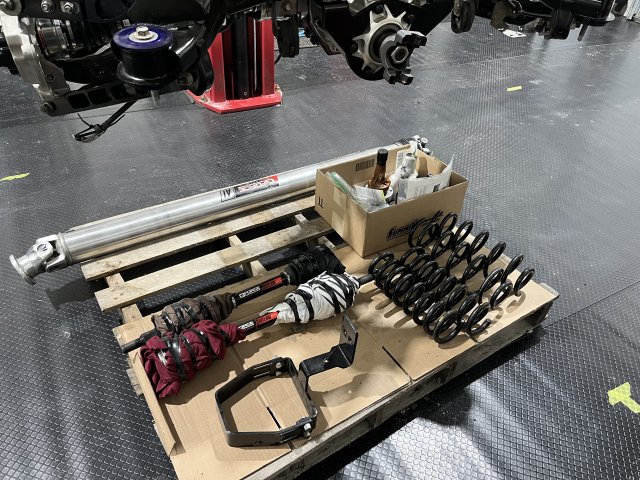

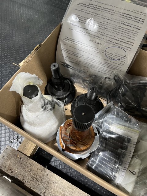

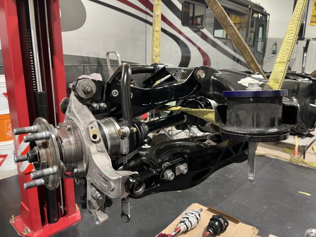

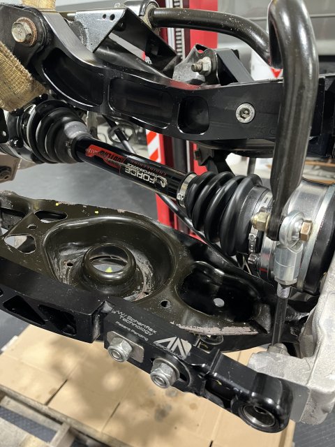

$3500 is certainly a good price for what’s in the picture. I see the AAD control arms and Gforce axles along with the differential. I assume the drive shaft is also a part of the package. The fact that it is already assembled means a simple cradle swap and you’re done. That would be some savings as far as labor goes. Downside could be that you are lowering your gear ratio to what will make 1st gear too short to work. Especially as you increase power. Look into what you need to know about launching in 2nd gear. And I will repeat this…. A 15” wheel/tire combination is 1000% better than a 17. I don’t care what kind of performance somebody got on a tight radial prep track with a 17. Real world… on the street and ordinary track surfaces, the 15 works when a 17 doesn’t.

This was the list I saw.
2015+Mopar Modified Cradle &complete 9” IRS kit with 3.25 gears, a 4” aluminum drive shaft and the GForce Outlaw axels currently set up with a spool but also has an Eaton Detroit Truetrac that he would sell me for 25 cents on the dollar.

I do see from your response though that you didn’t catch what I was referencing in the picture, it has what I would assume as the full AAD drag Pack already installed, or at the very least the wheel hop eliminator kit.
The Drag Pack alone would cost me $2500 Canadian.
Mark thanks for your input and I see you noticed the AAD stuff in the photo, I didn’t even realize this was included. The one piece aluminum drive shaft is leaning against the wall in the photo.
He also has the “Hellcat rear drag racing kit and will wood forged rear parking brake kit that he would sell me and I believe a set of 15” Weld wheels I could buy. My dilemma was I had already purchased a brand new set of 17” Forgestar beadlocks and front skinnies when I thought that would be all I needed to race. I wanted to keep the cost down by not doing the conversion.

I will say the phot that you posted is worth well over the price you are offered it for. I will offer my 2 cents. My car runs well into the 7's on a set of DSS level 5 axles, a billet IMS rear, cradle lock out and AAD kit. It really depends on how much power you plan to throw at it? if you are planning a built engine and trans them by all means that is great setup for you. if you aren't going to go all in, a simple cradle lock out, AAD kit and P4D diff brace and you're all set.
