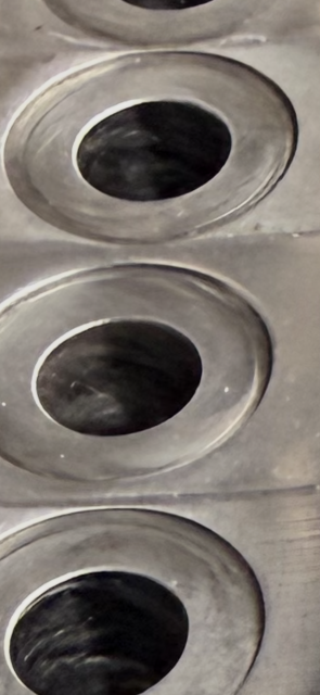

Are you pointing out that it failed because of a lack of chamfer on bolt holes? I see no witness marks from the stud and washer on that bolt hole.
3,823
9,057
Thread Starter #22
No, but why does the surface were the hardened stud washer sat have such a pronounced indentation from the washer? This is a 4140 material billet cap, they’re not soft. How did just torquing the nuts down on the washers do this? Aren’t the washers there to kind of spread the nuts load bearing surface out a bit more and provide a nice smooth hard surface for the nut to spin against and not dig into the cap?
Agreed that 4140 is a very tough material, I machine parts out of it all the time. It takes a lot of pressure to indent the flat bolt surface.

This surface is definitely part of the puzzle, it did not look like that when first assembled. They all looked like cap Number one. Why did it end up looking like that?

I assumed (ass of you and me) that the bolt hole was counter bored for the washer seat.

I assumed the caps were counterbored as well, squishing a washer into the cap is not a great idea.
Holes where countered bored for the washers and nuts, the indentations I was referring to are inside that counterbored area, the witness marks can be seen best in pictures in post 1. Here is a close up of that original photo.
