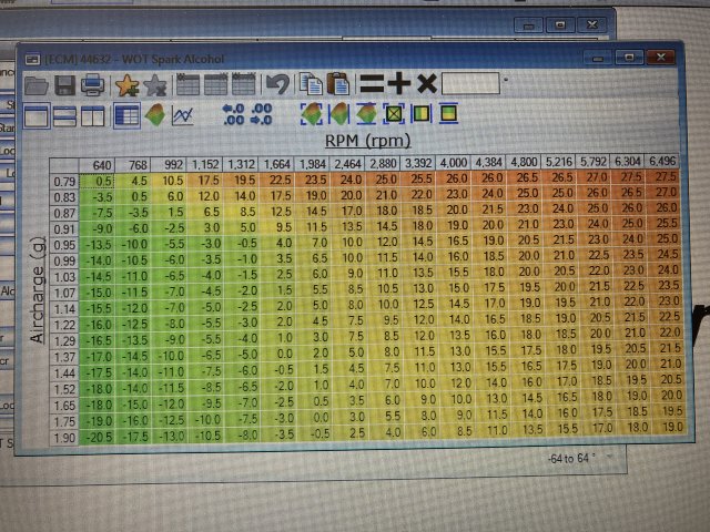

The most common "900whp" packages are tuned with 20-21 degrees on pump E.
My dyno charts of 10/20 where using this WOT timing map with sensing E77 I only got to 18.5 degrees in actuality.
Im hoping to get up to 21 degrees in the final timing table and with E85 and full timing end up around 950-975 wheel and torque up around 900 and I’ll call it quits and keep my fingers crossed it stays together. I’d be elated to crack 1000 but don’t want to crack anything else in the process lol. Next dyno visit is 11/5, we shall see!! 🤞 4C65A6A4-4C4A-46AB-83AD-4C5D2443432E.jpeg

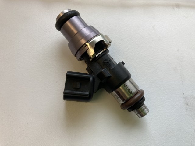

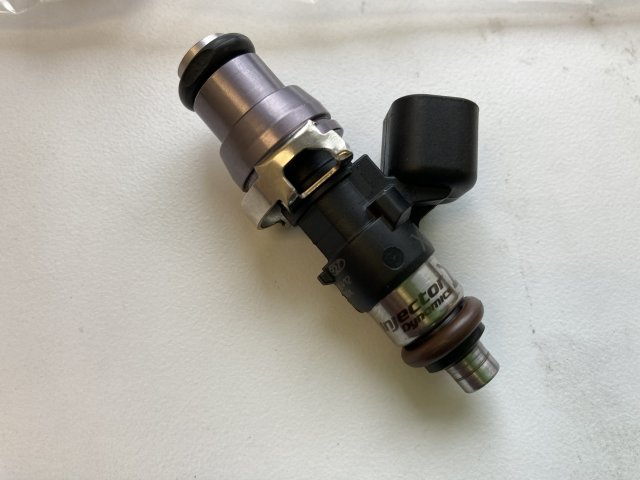

Thread Starter #99
ID1300X2 where designed with flex in mind and idle and part throttle stability when on gasoline. It’s what I originally planned to use and had a set but sold them when I found a tuner that said by 1050X’s where plenty for E85 and 17 psi of boost I sold the 1300X2’s to fund the tune.
28B08231-4250-41DB-930B-75BB8D0D1E7E.jpeg FA61C669-DA3E-4492-84CB-61585453C03E.jpeg 033F95C1-4970-41E2-BF7B-A1C7F7D8430D.jpeg
