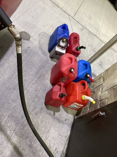

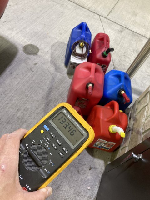

I went to the high station just before and stocked up on 83% E before this last station starts changing over to winter blend as well. Going back with 4 more new jugs over the weekend too lol. I need enough good stuff to last until at least mid November.
8D0C9BAA-85F1-41E9-9B90-7F0DAB76EE85.jpeg 3B17FAC9-7626-47FD-9C1A-A159F7C4A2F4.jpeg

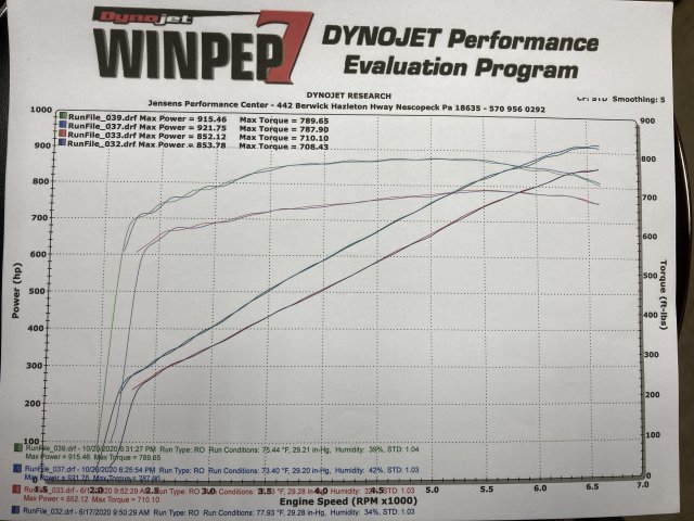

1Qt of Octanium per 15-16 gallons is fine especially if you trust your 93 your getting and are only making 16 psi of max boost. I make 17.8-18 at times on a 2.85 and that mix runs with no knock ever and makes 855 wheel on a dyno jet.
Here’s a dyno chart with 93 and 14 degrees of timing and E78 with 19 degrees of timing and a tame timing ramp.

It looks like the graphs don't match the numbers on the sheet there? Kinda odd if I'm seeing it right. Stops at 760 and 840?
